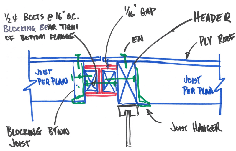

For a residential job, architectural constrains are minimizing the nailer thickness on top of W10 gravity beam. Wood roof framing face mounted to blocking in web of W10. The roof ply fixes to the nailer, so any fixings would need to be recessed.
What is the thinnest that the nailer could be? Threaded Nelson stud – how much recess is required? Powder actuated Fastners?
What about OMF with W8 beam and the nailer fixed to the underside of the beam for the window fixing. Load from roof diaphragm coming in blocking on side of beam.
Seems like if the nailer gets too thin, it is not worth having. I have used 3/4" before.
IF you need to anchor the plywood more closely than 16" o.c. THEN, what if you added blocking in between the joists/rafters? (Like you show on one side in the bottom late detail.)
Not sure how to adjust for the bottom mounted nailer. Maybe place a joist at either side of the beam?
One thing I see on your detail is the 3/4" bolts at 12" o.c. Typically I spec that the blocking must bear tight on the top of the bottom flange and I don't think the bolts really have to do much work in that case. I typically spec 1/2" diam. at 16" oc staggered.
I like your detail. No nailer. Then put blocking between rafters (ea. side of beam) so you can nail the plywood edge on the blocking

Thank you for the input. It was a W8 with 11.875 deep joist, but that was dropped to 9.5 for arch reasons. For the W8, another option would shift it over a few inches and run a HEADER along the glazing line with the OMF adjacent.
- - With a 3/4" nailer, how did you fix that to the top flange?
- For weld stud on top flange, what is minimum recess? 3/4" bolt nut is nearly 3/4" in thickness. 1/2" stud would seem too small to weld.
- If using engineered lumber like LSL, is air ga still recommended?
3/4" plywood glued to top flange. Might also use power actuated fasteners.
I'm not a fan of welded studs in such a short length. (That wasn't my suggestion.)
Also - I don't like the way you've anchored the header on the right side of the steel beam. Seems like the joists should attach directly to the infill blocking as it is more reliably supported by the bottom flange and the beam. Then the blocking goes in between the joists (as on the .left side?). Just seems more reliable all around. (I did not realize that was a window wall before.)
