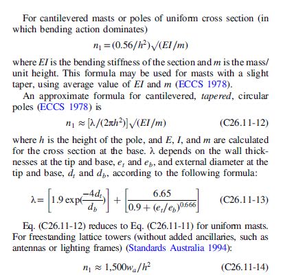

Greetings!
Have a ~200 FT pole Sign with a huge cabinet on top. As such, we have a lumped mass at the top, and we have what I would assume to be a non-negligible mass of the pipe along its length, which decreases along the length from top to bottom. Obviously, 'I' decreases, too.
There is a related post from about a decade ago, which gives some insight, but it seems the responses and some of the resources such as ASCE commentary are limited to cases with a lumped mass or a pipe with a relatively uniform mass and 'I' but no ass at the top.
Is there a good approximation (such as a summation) for working with a multi-stage pipe structure ("tapered" pipe) and with a lumped mass that can be done by hand without jumping into the depths of modal analysis in RISA (or the like)?
Maybe there is a resource out there I have overlooked?
Asking for a friend.
One suggestion- see Section 15.4.4 in ASCE 7-16. For that application, I would approximate the tapered shaft as a number of beam segments with stiffness and mass of segments varying as you go up. This is not a "hand" calculation, but is not too tedious if done by Excel.
In the AASHTO standard sign spec (Standard Specification for Structural Supports for Highway Signs, Luminaires, and Traffic Signals, 5th Edition) Equation C11.3 gives an approximation of the natural frequency of a tapered pole with a concentrated mass at the top. I recently compared the results to the observed oscillation of a 120' high mast light light tower, and the calculated frequency was within 10% of the observed.
Can also make a program (mathcad) that solves the integral with M(x) and I(x) to get the flexibility of the shaft.
Refer to ASCE 7-16 C26.11 page 753

Rayleigh's method will give you the first (lowest) natural frequency with ease. Another option is to code a small FEA solver in e.g., python or Mathematica; you don't need to use lumped mass in that case, just take density and 2nd moment of area of the pole at each segment as an input from an excel file. The third option is the canned solution proposed by BridgeSmith.

The method JStephen pointed towards in ASCE is essentially the Rayleigh method.
I'd say there is another easy way to do this.
1) Calculate the mass of the "huge cabinet".
2) Model the tapered column in RISA, or SAP or whatever program you use.
3) Apply the vertical load from the column and cabinet on the model, and apply a 1 kip lateral force (more if you need more significant figures). See what kind of reaction you get at the base. This gives you the stiffness (Kips per inch of deflection). If you had P-Delta included in your analysis then this also accounts for the loss of stiffness due to 2nd order effects.
4) Finally, the natural period of the structure would be: T = 2*pi * sqrt(M/K). And, frequency = 1/T.

To answer the recent questions, the pole sign is 183' tall and yes, we are trying to get a more accurate Gust factor since this is abnormally high.
Our initial estimation was a period of 2.5 sec (0.4 Hz) for initial calculations and it seems the method from AASHTO puts us at 0.56. Interestingly, we started at 1.15 as our general standard for higher signs, but it was causing this to be a bit impractical, so we needed to see if we could reasonably refine things.
