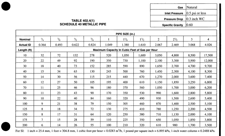

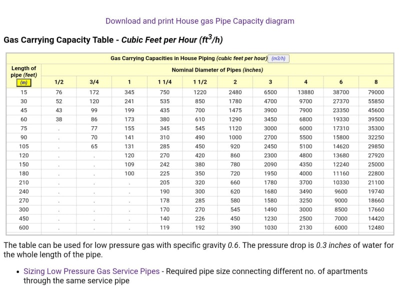

I don't mind. I find tables can be pretty helpful in that they can often prevent errors typical of bad copy paste operations, or at least serve as a quick check of your own, or someone else's calculations that are not entirely transparent, or if I just need a quick look for commenting in this forum and I don't want to waste time turning on the desktop.
BTW it looks to me like all the tables agree pretty well, but
you do have to look at the same length and same diameter.
4"∅ x 60ft long all show 6800 ft3/h

I agree tables can be a quick check on things and I use them as such.
Your table seems to be a bit more conservative than the code tables, which is not bad. The reason I don't like the tables in the IFGC is the more recent versions got rid of the first table from 2003. The table from 2006 (and on) uses inlet pressure of less than 2 psig for this application. However, the formulas used for sizing that are also part of the code are different if inlet pressure is less than 1.5 psig than if it is greater than 1.5 psig. Also, the tables have a hidden "safety factor" which is not readily recognizable. Your table has an even greater safety factor than the code tables at smaller pipe diameters.
I prefer equations because then I can apply the safety factor I want to use.
Of course you are free to use whatever you like, as pipe flow safety factors don't really exist in the world of codes. It only has to do with how well the maximum flow for any given pipe has been defined.
