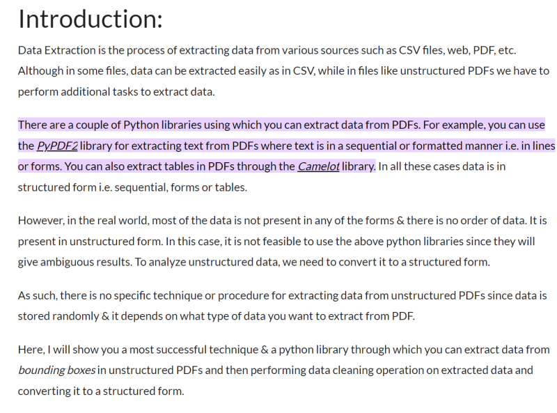

Has anyone run across spreadsheets of the wind/snow/rain etc values in the Canadian Building codes as tabulated data? I have never been able to track it down. Obviously it must have been a step in the creation of the document, but I can't find anything shared other than the base data used for the seismic portion.
I've gone through before and manually entered a bunch of data when I want to make a calc sheet that can do the lookups for me, but it's error prone and hugely time consuming. The PDF tables don't do well when I try to automate extraction.

It would not be overly complicated to write a code to extract the data direct from the .pdf file. I bet Celt could do it in an afternoon. The Jacabus tools are great. Great find for the schedules. You can download fillable versions too, but this looks easier.

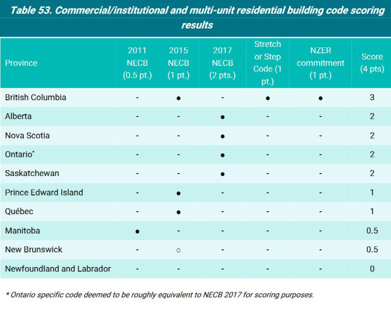

Not to hijack this thread, but on a related note: Has anyone heard anything about the rolling out of the new codes? Obviously the NBCC 2020 was just released recently, but I haven't heard a peep beyond that.
Haha, where I practice we're still using the 2010. It's borderline embarrassing. We're due to enact the 2015 code on Nov 1st. At this rate, we're not getting to the 2020 until 2030.

Jayrod... Manitoba... at least we are ahead of Newfoundland and Labrador...This is really important when it comes to energy efficiency. [pipe]
@jayrod12, Wow, that is very slow! I agree it's a little embarrassing. I don't know a lot about how the codes are modified for individual provinces but it doesn't seem like it is working very well.
@sonofatkins, Definitely some big changes. For agricultural buildings too, everything now needs seismic design. Would just like to hear someone saying "be ready for this at the end of 202_"
