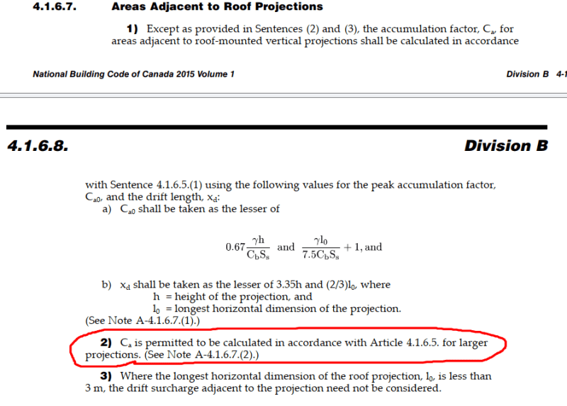

Good Morning,
I am determining the snow drift load on a low roof, which is adjacent to a high roof.
I know that the leeward case is covered by snow load case I for lower level roofs (4.1.6.5), and the windward case is covered by Case II.
Out of interest, I wanted to see how the load would compare if I treated the high roof as a projection (cl. 4.1.6.7). The snow load in this case would be significantly higher.
I just want to confirm that there is no need to check an upper / lower roof case as though the upper roof is a projection?
Thanks very much for your input!
No you do not need to check the upper roof as if it is a projection.
In fact, NBC 2015 clause 4.1.6.5.(2), allows you to calculate the snow load adjacent to projections using the lower roof clauses instead of the projection clauses.
In summary:
- When you have a low roof, use the low roof clauses.
- When you have a projection use the lesser snow load calculated as a projection or a low roof.
