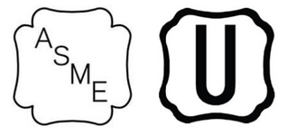

Hello All,
I have an interesting situation hoping to get some insight. My company built an ASME Section VIII "U" stamped pressure vessel back in the 1980's and the user has requested a replacement nameplate. NBIC Part 2 Section 5.2.1 states the following, "All the re-stamping shall be done in accordance with the original code of construction, except as modified herein.". The problem is back in 2013 ASME changed their authorization stamp from the "U" symbol to the new "ASME" symbol (see below) and the "U" is longer able to be used, technically making it non complaint to original code. Couldn't find any interpretation on this so I'm thinking about just leaving it unstamped. Any thoughts on this?
"Original Code of Construction" just means if it was built per ASME Section VIII Div 1 you must follow ASME Section VIII DIv 1. It does not mean that you must comply with the original Edition of the Code of Construction (although this is usually permitted).

So I don't see any issue with using an "ASME" stamp in lieu of a "U" stamp but confirm with your AI and follow the instructions below for completing form NB-136:
