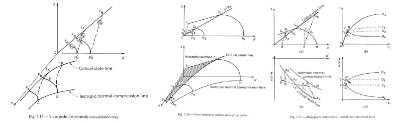

Hey everyone:
For NC clay with stress path shown, after excess pore pressure dissipates, where would the drained shear strength lie? At around the TSP line?
Cheers
When estimating shear strengths for natural clays, drained strengths increase after a long time for natural deposits. End of construction / staged construction / operational loading is usually the condition to consider. The drained strength would lie as shown in leroueil.

drained means effective. Undrained means total. You have an effective stress path and you have a total stress path.
f-d
ípapß gordo ainÆt no madre flaca!
The 'drained = effective' and 'undrained = total' may be a little confusing: you can have an undrained test with an effective stress path, for instance. Also, the key parameter for total stress analysis is the deviator stress, which is the same in effective stress and total stress space. I cannot see the application or relevance of a total stress path. I'm happy to be provided with examples of its relevance, if there are any.
It's also worth noting that, in the stress path image above, the total stress path will only ever start at the same point as the effective stress path if the total pore-water pressure is zero.
While it's true you can use undrained shear strength tests to derive drained behavior, it requires pore pressures to figure out the drained behavior.
I'm sticking with my earlier statement. If effective strength is reported, that's what you'd use for drained behavior.
f-d
Hey everyone, is there a reason for calling it "drained behaviour" when the undrained shear strength test forces the sample to fail in an undrained manner? I understand that in the test you can find the effective strength parameters through the pore pressure measured, but excess pore doesn't dissipate though.
I always thought that the total stress and effective stress behaviours in the undrained test determine undrained shear strength, which is shown as Ua/Ub in the figure above, and that the drained behaviour correlates to TSP line shown above, because NC clay gains strength after a very long time.
Thx
That's kind of my point about this 'drained = effective'/'undrained = total' stuff - it's misleading.
The pore pressure doesn't need to dissipate since drained or undrained you will always end up on the critical state line (CSL). Look up critical state soil mechanics for more information. Essentially it is a 3D space of e-p'-q; you are looking at the p'-q plane in the above example.
Further to my gripe above, I'd prefer the terms 'constant volume' and 'constant stress' to 'undrained' and 'drained', respectively. You'll see why when looking at critical state soil mechanics.
As noted by others, under fully 'drained' shearing, the soil may go further than the undrained shear strength. Note: this might not be your failure stress path, however. I understand there to have been a number of dam failures due to a misunderstanding about the failure stress path. I don't know much more about that, however.
The 1:3 angle of the total stress path is the same as the drained effective stress path because one out of the three principal stresses are increasing while the other two are held constant. However, as I noted above, the total stress path only starts at the same point as the effective stress path if the total pore-water pressure is zero; otherwise it would start at a different mean total stress (p) value.
Thank-you so much LRJ and everyone [bigsmile]
Just wanted to provide illustration to LRJ's comment on critical state and e-q-p space to supplement the previous image shown from Leroueil Embankments on Soft Clay, Highly recommended resource for understanding clay behavior.
