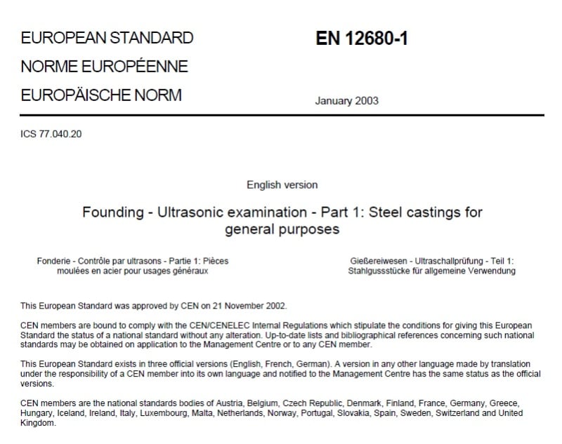

EN ISO 12680-1 gives guidelines on performing UT on ferritic castings (with grain refining heat treatment) upto 600 mm thickness.
You can use this standard outside of its scope but with dedicated procedures, drafted by a L3 UT technician/engineer.
EN 12680-1, not EN ISO 12680-1 as I stated in my previous post. Apologies, this happens when you're quoting from memory.
But it appears the ISO 4992-1 is very similar to the old EN 12680-1 after a quick browse through, and much more recent (2021 instead of 2003). So probably over all a better suggestion.
