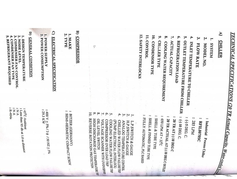

we have ordered 20TR Brine chiller for our pilot plant purpose. recently i checked the chiller specification sheet and i was curious to do the reverse calculation based on the data provided by vendor. i did the calculation using the website
I have attached the excel sheet for my calculation but i get only 15TR capacity instead of 20TR.
Can anyone just check my calculations ? is this correct ? if any errors please tell me where i have did the mistake ?

Please find the attached chiller specification provided by vendor.

This should be an easy check with the manufacturer. I don't use metric units and don't have time to convert and double-check anything. But the nominal tonnage rating of a piece of equipment is based on certain flow and temperature conditions, and it is most likely based on straight water with no glycol. The addition of glycol reduces capacity. I know that's not much help, but I would check with the manufacturer on how they determined that the unit was 20TR.

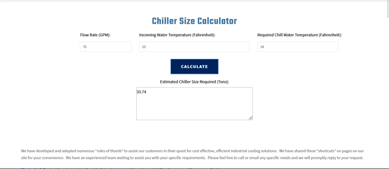

Consider this link to support:
Simple, No?

i tried that calculator already but i don't think it will work for all kind of chillers because we use methanol for anti-freezing agent in brine chillers so the specific heat of the solution may vary. that's why i made this steps for accurate load calculations.
you can see there it suggest me to go for 33 TR chiller but we don't know the background steps and parameters involved, hope you understand my point. this is my curious to know that's it.

The point is that RT is a unit of power: 1 RT =12 000 BTU/h
In your case, based on the link shared:
Oversized capacity is 20RT or 20*12 000= 240000 btu/h
Capacity required (theoretical) should be: 240000/1.2 = 200 000 btu/h or 58.61 Kw
which allows a cooling flow rate of:
58.6 /(cp *delta T) = ..... kg/s
cp in KJ/Kg K, delta T is 5 C or K
Make sure you have the properties of your coolant with the right units.
A google search: Cp is about 3.4 kJ/Kg/K and Ro about 930 kg/m3, different from your data.
The question mark is how concentrated is your brine? this will affect the properties of the coolant.

cp in KJ/Kg K, delta T is 5 C or K.
In my case the det-t value is (-5 C). This is brine chiller so.
You are referring chilled brine if yes, those properties are in correct units.
i have attached the pdf for taking values of chilled brine water solution like
Density of the brine at -10 C at 50% mixture is 935 kG/M3.
I took specific heat values from this site for -10 C.
Sp.heat of the brine at -10 C is 2.36 KJ/KG/K.
