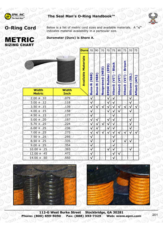

Hello All,
I need to buy below O-rings for a project and I can’t find a supplier to buy them. Can you check these sizes/specs and let me know if I am missing something? What is so special about these O-rings?
350 x 5.7mm spliced and vulcanized EPDM 80 durometer o-ring
160mm x 5.7mm spliced and vulcanized EPDM 80 durometer o-ring
530mm x 5.7mm spliced and vulcanized EPDM 80 durometer o-ring
507mm x 5.7mm spliced and vulcanized EPDM 80 durometer o-ring

Thanks Robertib. Is 80 durometer O-ring not common? What about the bigger O-rings? Are they totally out of range? Can O-ring stock cord be supplied and we can cut and glue the o-ring? Is that reliable?
custom made O-ring
Since they are all 5.7mm you could buy cord stock and make them.
Build a small jig so that you get exact miter cuts.
And a way to hold them aligned when you glue them.
