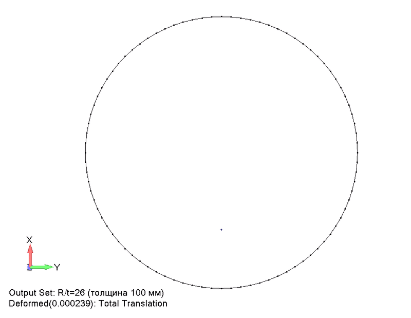

You "touch" roundoff errors due to ill-conditioned matrix by making simple test example. Make cylindrical surface? mesh it with plate (PSHELL) elements, load them with pressure and constrain one node of mesh in all DOF`s. Now start to decrease element thickness - increase radius to thickness ratio (R/t) and check deformed shape. At some point deformed shape become non physical. If you enable double precision then deformed shape of "bad" results will be OK.
