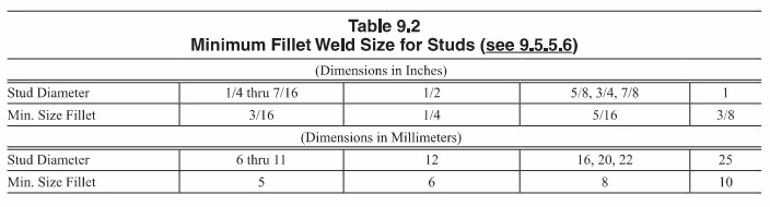

Minimum fillet weld sizes for studs per D1.1 are:

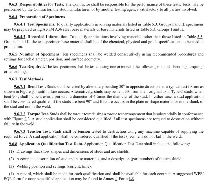

D1.1 also has testing requirements that need to be performed whether it is fillet welded or welded with a stud gun:

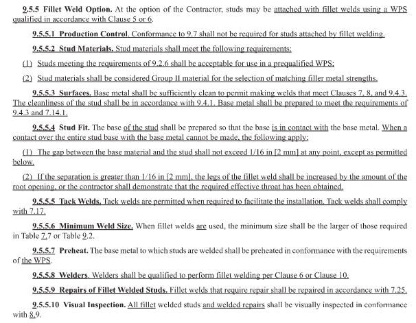

If the project specifications follow/refer to D1.1, then the contractor has the option to use a fillet weld rather than a stud gun (no matter what the drawing may show):
