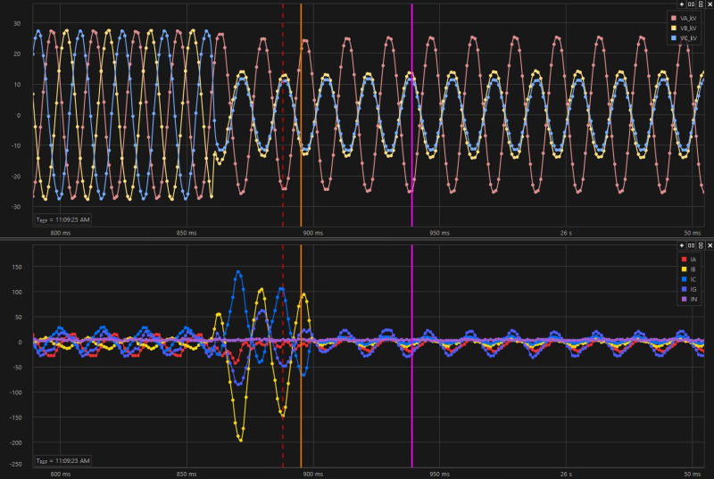

There is an SEL-351 at the 33kV utility connection. Here's what the event records show from the utility fault.
Seems that the fault caused a shift in the center point of the high side winding, which caused current to flow in the NGR.
I believe our best course of action is to keep the system solidly grounded. However, I'll need to either convince the owner that the generator is adequately protected without an NGR, or I'll need to add extra protection for the generator. Do genset controllers typically provide adequate protection? I believe the genset size is 835 kW.
