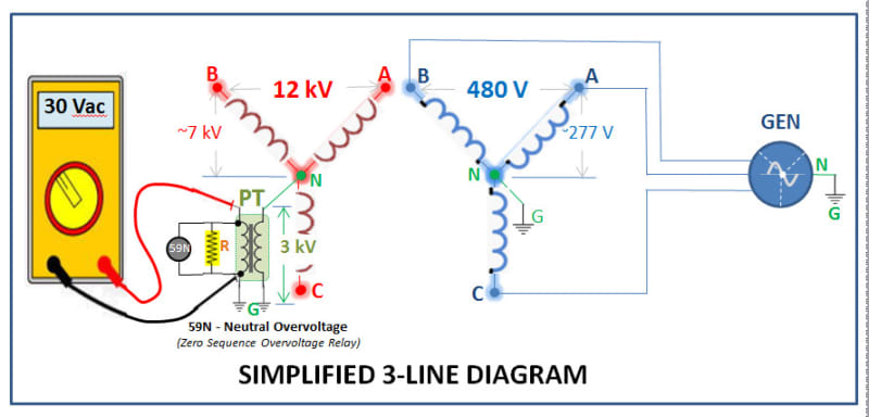

Hi all,
We have a wye grd - wye grd 12kV - 480V transformer. The utility lines are 12kV 3 wire and the neutral of the primary windings are grounded through a potential transformer (PT) at the transformer pole. The neutral of the secondary is grounded the main 480V panel. This is a generator facility, so the output of the primary PT is connected to a 59N relay per utility's requirement in order to detect ground fault on the utility side and disconnect the generator, so it does not feed into the fault.
However, we are seeing significant neutral voltage on the PT. We measured 3,000V from the neutral of the wye on the primary side to ground. On the 59N relay, we are seeing ~30V which comprises of almost pure third harmonic voltage.
The L-L voltages on the 480V side looks normal around 460-470 V with 2% VTHD but the L-N voltages on the 480V side shows very distorted waveform with 40% VTHD, we are seeing about 120V of third harmonic voltage on 277V L-N.
This is all when the transformer is unloaded and generator cannot run because it keeps tripping intermittently from 59N.
Anyone has any ideas what could be causing such significant third harmonic voltage and neutral overvoltage?
Utility says they are not detecting any ground fault on the 12kV incoming lines. We checked the grounding on both primary and secondary side of the transformer and everything looks normal.

It appears that the transformer is under overexcitation caused by saturation of the steel core due to the high harmonic level in combination with potential ferroresonance associated with the PT.
There are a few suggested options to study the possibility of reducing the neutral harmonics as follow:
1) The PT act as a neutral grounding transformer (NGT). Adding the proper size of the resistor will convert the system in high resistance grounding and possibly mitigate the neutral overvoltage.
2)Adding a 3rd and 5th harmonic filter could reduce the Voltage harmonics
3) Adjust the transformer taps reducing the voltage
4) Delta transformer can block the flow of zero-sequence harmonic current.
5) A broken delta vs. single PT scheme is more commonly used to detect neutral overvoltage using 59N relays
6) The 59N, neutral overvoltage relay to monitor the zero sequence.
The following sketch is our the interpretation of the original post added to illustrate the discussion.
We hope this help.
