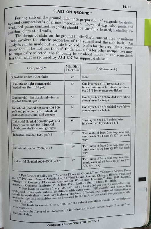

Hello All,
I am building a new industrial PEMB warehouse.
10K SF, 16' clear, steel construction.
Tenant expected to be service, trade, light mfg, assembly, contractor, etc. Basically light industrial use.
Racking limited due to clear height. 3 levels up to 12' pick.
We are in the process of determining slab specs.
GC says 4" w/ FM slab.
Arch says 5” w/#4@12”OC EW
This will be over 12" abc.
Is one underbuilt, and the other overbuilt?
Is the steel fiber reinforced concrete an option, offering strength, less concrete, competitive economically?
Appreciate the insights you can offer.
Thank you,
Paul
4" feels light to me. 6" would have been my default but I could probably be talked down to 5" for truly light commercial / industrial.
The clip below is from an old CRSI manual. Antiquated as it is, a lot of engineers still use this as a starting pace for slab thickness.
The steel fiber is just another means of achieving crack control in most cases.
Thank you for your response KootK. Very helpful.
Best
Paul
I'd never use a 4" slab for anything but residential. 5" min, maybe 6" if it's possible for a different future usage. I never use WWF in a slab... I've encountered too many of them where the reinforcing is in the bottom of the slab. I also use PEVB between slab and base material. I only use steel fiber for serious industrial slabs... not for light manufacturing.
