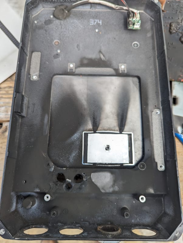

I installed a new 10hp, 480 volt VFD on a pump the other day. I tested and ran the pump for a short time while I got the parameters squared away. About 24 hours later while the drive was energised and NOT running this happened.

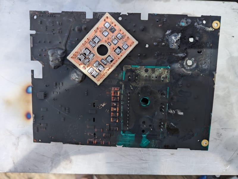

I'm curious, in the first picture it detonated one of the wires leading into the disconnect switch. It also detonated all 3 wires between the disconnect switch and the circuit board. It also burned the leads on the components in the final picture, they appear to be MOV's. The fault didn't clear a 40 amp breaker. The input wiring was 8 gauge and the 3 leads that failed were 10 gauge.
This failure is odd to me. I don't usually see all 3 phases go short circuit. This drive is in a high vibration environment. In fact, the 4 year old soft starter it's replacing died because all of its capacitors vibrated off the board and it appears one caused a reverse polarity event when it rotated around it's still connected lead. I mounted this one on soft mounts and was surprised to see a failure with 24 hours.

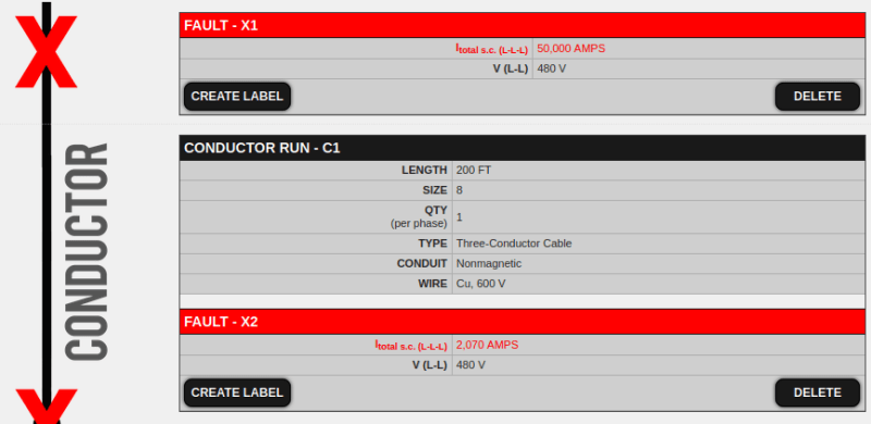

Using Bussman fault calculator, ignoring the fuses , and using the limited information provided (reference I estimate your fault current is around 2000 amps, which may result in slow clearing of either a fuse or a breaker. Current limiting fuses can further delay clearing, by pushing the fault current lower.
This is one reason current limiting fuses are not a shortcut to a solution for correcting available fault vs SCCR mismatch.

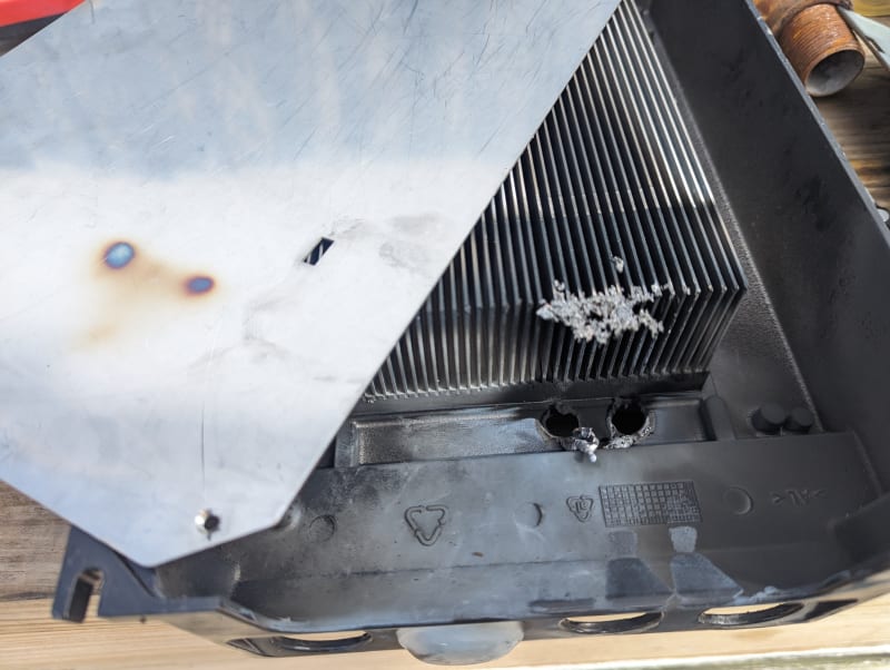

The manufacturer didn't want the drive back so I got to do an autopsy. Looks like a diode evaporated in the Power Integrated Module which created the initial arc flash to short the three line terminals. The flash sustained itself long enough to burn 3 holes completely through the aluminum chassis.
That may have been secondary to a DC bus capacitor failure, possibly even an MOV failure. Is it a 480V delta system by chance?

Another note, in the marine industry metal electrical enclosure are bolted to the metal hull of the vessel. Bonding straps are essentially non-existent. This drive was isolated on a fiberglass adapter plate. The drive is mounted on a fuel tank and the fiberglass plate adapted mismatched bolt holes. Welding new brackets to fuel tanks gets expensive. The replacement drive has a bonding strap.
