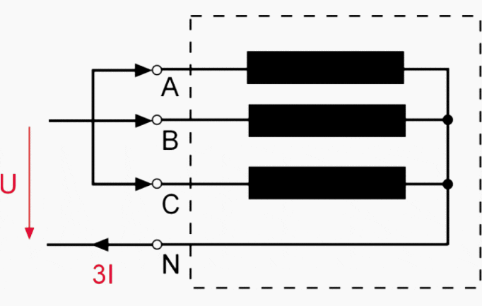

First: remember that you need to use the zero sequence impedance of the grounding transformer, not the rated one. This Zo its kinda hard to calculate... assume its 0.9~0.95 of the rated impedance. Unless you already have this value from test, of course.
Second: All transformers impedances are rated as "per phase" values. This means that you need to use one third of the value and then add it to the NGR impedance. This gets clear when you remember how you measure the zero sequence impedance of a 3ph transformer:
Case 1 above with this last correction will become:
c. The equivalent impedance = 5.7/3 Ω + 1 Ω = 2.9
d. The estimated the overall ampere rating will be 13800 V / √3 / (5.7/3 + 1) Ω = 2747 A
Same with Case 2.
Which is basically the "Thevenin formula" you found for the second approach and will give you the same results. (I've ignored the 0.95 correction factor just to facilitate the comparison with the results you obtained).
