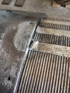

We were contacted to advise on our recommended inspection after a generator had been motored at synchronous speed for an extended period of time (40mins)
The entire event was approximately 80 minutes.

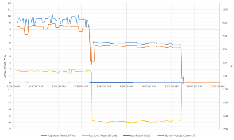

1. The field exitation was lost - and generator protection failed to trip - the generator was motoring but still driven by the turbine for approx 40mins.
2. The Turbine power was removed once motoring was noticed - and the generator motored at approx 2998 - 3003 RPM for 40mins still without excitation.
3. The stator was finally isolated and the unit spun down.
Given this sequence of events we advised a caps-off inspection in which we anticipated to see some arcing damage between the wedges and the end caps.
We have since recieved and partially completed the caps off inspection. Identifying almost no damage to either the retaining rings or the slot wedges.
Is this typical of a loss of excitation event when it occurs at synchronous speed (50hz)?
What detail could we have missed that would have protected the rotor from damage and avoided the arguably uneccessary forced shutdown?
Are these events only destructive when the rotor speed is significantly different to the synchronous speed of the stator?

The stator had approximately 60% of its operating current on its windings during the event.

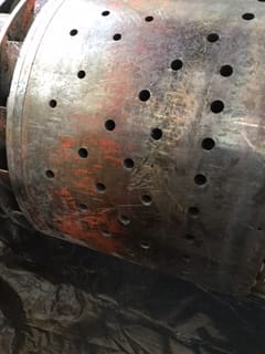

Rotor winding got cooked with overheating of pole faces & retaining rings, wedges meltdown near the RR's. etc.
Rotor rewind with new RR's and wedges done by us in 2017.

Edison, That is the condition I expected the rotor to be in given the explanation of the event I recieved. It is actually a similiar design to that unit.

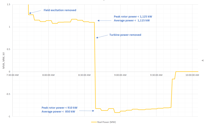

The attached data may assist.
Even a 1% slip would have taken the speed down to 2970 RPM. A 3% slip is in the probable ball park range. So, if it truly tracked normal system frequency it wasn't acting as an induction motor.

Were those RPM values measured or were they calculated from the electrical frequency?

davidbeach, I believe they were measured.

Given the condition of the rotor we assume there must be a misunderstanding or assumption from the end user concerning the actual running conditions during the event.
And given the lack of slip frequency mentioned in davidbeach's response - There must have been some field energy during the suspected motoring period.
If anyone could share some generator telemetry data from an actual motoring event/loss of excitation at synchronous speed. I would be very curious to study this.

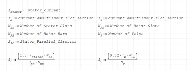

Klempner addresses it in "Handbook of Large Turbo-Generator Operation and Maintenance". But based on these equations the stator current (approx 520A) would be high enough to cause damage.
Noting the damper winding in the slot section consists of 1 x 2mm thick aluminium strip and the retaining ring acts as the shorting ring for the winding (there is not "under-cap" amortisseur).
Is there any ways of determining damper winding load based on slip % + load?
