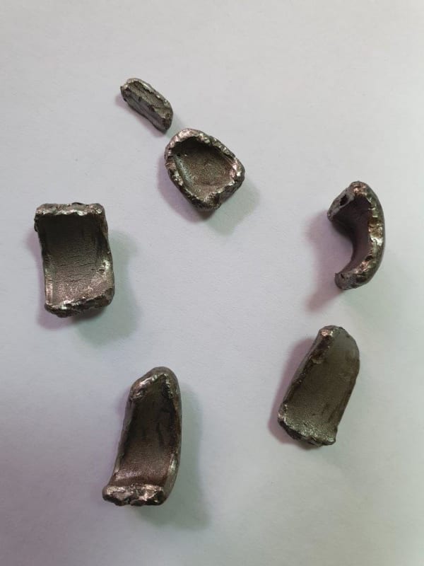

WE FOUND SERIOUS DAMAGE ON THE FIRST STAGE IMPELLER ( photos attached)
with a metallic debris in suction line or piping of the compressor.
the question from where they come this fragments of metal?
before entring the gas compressor we have filter and then flow control valve (Valdisk BX Control Valve)
and also a fragments of Teflon and PTFE.

After dismantling the butterfly valve (control Valve Model:Valdisk BX flowserve)
we found the spiral wound with SS outer inner ring damage ,deterioration of the gasket it was the main cause of the problem
the choice of the gasket was not right 12" Instead of 14", so the inner ring was not centrend and enter in contact with disc at each starting of the compressor until the cutting of the half inner ring and drawn in the impeller.
I think it was well explain
see you friend's
 https://files.engineering.com/getfile.aspx?folder=bf39b648-4421-4eed-8964-e2955d807b03&file=IMG_20230606_140505.jpg
Well 14" is a bit of an odd size. Surprised it actually sealed though.
At the same time take a look at your filter if you can. Personally I hate those witches hat type filters as they are very difficult to remove and can easily break.
Those fragments in the other photo though look like something else and not gasket related. Possibly two different things? Please check your filter and other instruments between them. Could also be parts of the compressor?
Okay, presume Cooper wont cover you for the cost of repair/replacement parts in the compressor for this oversight.
