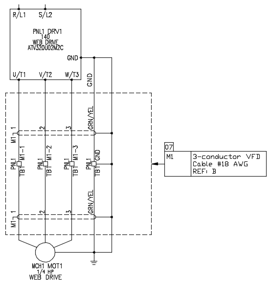

I am working on the electrical design for a small machine that will have a single VFD that drives an AC motor. The VFD has an integrated EMC filter and is CE approved. I have hired CE consultants to oversee my design process and (hopefully) give us the go ahead to put a CE mark on our machine after it is built. For my motor power cable, I will be using a VFD rated shielded cable with four conductors (three current carrying conductors plus a green/yellow ground conductor). This cable would go from the VFD to terminal blocks in my electrical enclosure, and then from these terminal blocks out of the electrical enclosure to the motor. I like to include terminal blocks for my motor cables because it allows my panel builder to neatly run the cable from the drive to the terminal blocks, simplifying the connections that I have to make after the enclosure is installed. It also simplifies maintenance should my customer ever want to disconnect cables from the enclosure for some reason. My originally planned motor power circuit is as shown on the following illustration:
As can be seen on the illustration, my original plan was to land both the green/yellow ground wire and the shield at all three of the following locations:
[ol 1]
[li]At the ground terminal of the VFD (DRV1)[/li]
[li]At the ground terminal block[/li]
[li]At the ground screw in the motor’s built-in conduit box[/li]
[/ol]
When I presented this plan to the CE consultants, they told me that EMI or shield grounds should be isolated from the main safety ground. The purpose they say for this separation is that all of the noise being filtered out of the AC line by my filter is shuttled to the main safety ground plane. If I tie my shield ground to the same point electrically, that noise will likely travel on the drain wire out the the device. They say one way they have seen this addressed is with a ground bus bar mounted on isolating (thermoplastic) hardware. There is enough dead metal to dissipate the noise but is reliably separated from the main ground.
He says the termination point would be as follows:
I am just wondering if anyone here knows of any manufacturers that might sell hardware specifically designed for this type of noiseless / clean ground of cable shields?
Any suggestions will be greatly appreciated.
Thanks in advance,
Paul

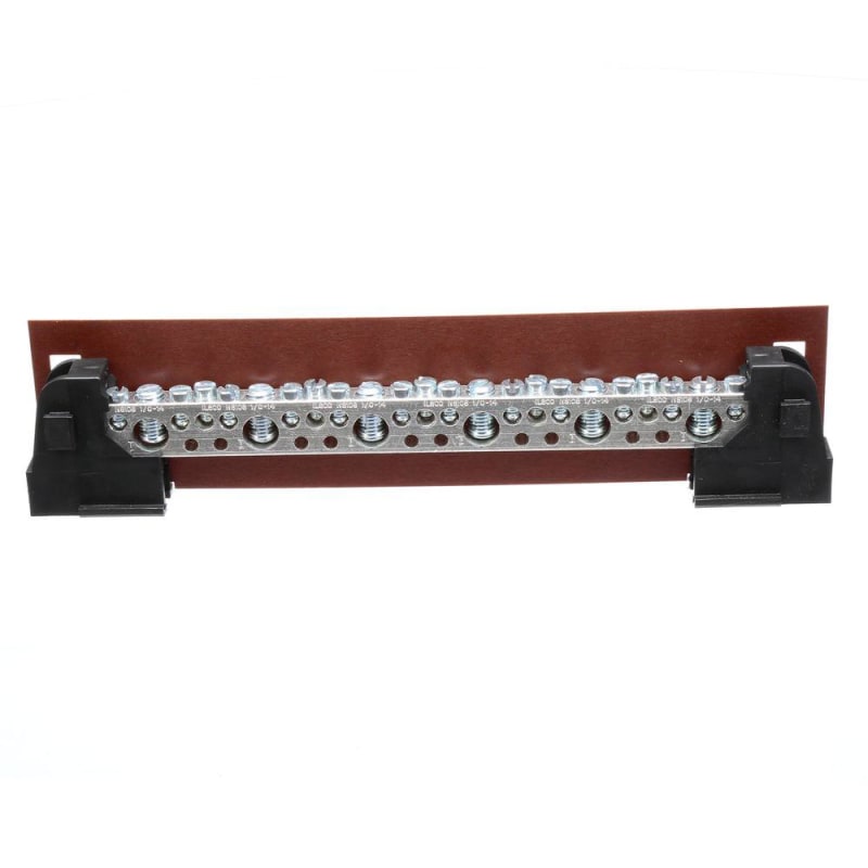

I would just use as big of buss bar as practical. I believe the idea is to create a low impedance path, with a large surface area, to give the noise a chance to dissipate before it reaches the main ground, which could cause other issues with sensitive electronics. I haven't really checked into if this is offered as a package from a manufacturer since it really is just a big chunk of copper.
Don't use the ground terminal on the VFD for a ground junction point.
It is meant to be grounded, not as a point to ground other components.
Install a generic ground bus that will accommodate The largest ground conductor that will be used.
Ground everything to that bus.

The diagram indicates the shield is grounded at both the source and load locations. Standard practice is to terminate at one location. This will eliminate shield ground noise.

You can buy neutral kits that are various sized busbars riddled with holes and matching screws and a plastic stand that holds the busbars separate from whatever the plastic stand is mounted to.
You can get these things up to at least a foot long. Use one of them and then ground it using one of the screw/holes.
These are sold at any electrical supply place.
With a VFD you run a LARGE surface area ground from the motor directly to the big grounding screw on the VFD and nowhere else.
The large surface area is needed because the high frequency noise generated by the VFD modulation fully puts it in the skin-effect realm. The current will be traveling only near the surface of the conductor. Without a LOT of surface area the ground will present high impedance to the high frequency noise coming out of the motor and trying to return to the VFD and it will instead wander in all directions causing problems.
You then use the 'other' VFD ground terminal to connect the VFD to the safety ground in the enclosure the VFD is mounted to. This way there is no impetus for the noise out of the motor/VFD to go out to the safety ground system as it has already returned to the VFD.

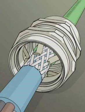

Hi Mark, Keith, dpc, Bill, mparenteau, and buzzp,
Thank you all for your thorough responses. This seems to be a complex subject that stretches the limits of my understanding. For this project, I decided I would reduce complexity and the likelihood that the consultants I have hired for assistance with CE compliance will find something they don't like in terms of EMC by giving up the idea of having terminal blocks for the cable from my VFD to my motor. After giving this further thought, it is really just as easy for me to land the cable from the motor directly at the drive terminals. Per the suggestion of the CE consultants, I am planning to strip back the insulation at each end of this VFD cable to expose its braided shield. The VFD comes with what they call an "EMC plate" that allows me to grip the braided shield with a clamp provided for this purpose. On the side of the motor, they suggest I use what they call an "EMC gland" that appears to have internal metal "fingers" that will make contact with the shield. I have pasted an illustration of both the EMC Plate and EMC gland below.
I do not fully understand how this is different than "directly" landing the shield at a ground terminal (at either the motor and/or VFD), but as long as the CE consultants give me approval for this, I think I should be ok. This is a simple machine with just a 1/4 HP motor, and I have made similar machines work without issue when I paid less attention to EMC. I just need these consultants to sign off on my work, and of course, I am always interested in building the best machine possible with the most robust design.

It's about the skin effect. The power is flowing at the surface of the conductor, think like a halo around the conductor. If you mash the shied down flat at the ends you are reduce the surface area of the shield to the surface traveling current increasing the impedance unnecessarily. Using a metal plate on one side alleviates this clamping crunch because the current can transition to the plate's large surface area. On the motor side the 360° grips preserve the surface area connection of the current flowing off the entire motor case onto the shield. Tiz all good stuff.
That said it's overkill for 1/4hp. You could use coat hangers with spacers taped to the connections and not have a problem.
