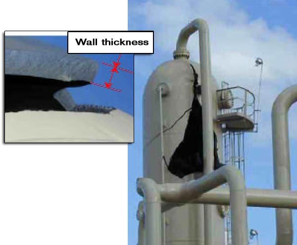

I do not want to remind the calculation proposed by goutam_freelance (Mechanical) is based on the assumption of no heat transfer.. But just to remind the risk of thermal shock which the tank will be exposed to..
I write vessel thermal shock and check the web.. One of the possible outcome for the risk,
This vessel hydrotested and exposed to thermal shock..
I am not sure for the reason for compressing the air in the vessel but i think that it is not a good idea that , the use of 80 degr c hot water for -20degr tank. The temperature difference 100 degr. is substantial amount and may initiate the cracks . I will recommend the use of air or ask the services of expert to assess the risks for thermal shock.
