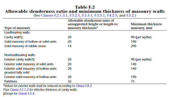

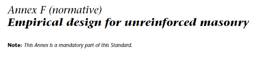

There is still empirical rules in the Canadian Masonry Code that allow for unreinforced masonry walls. I would never do it for a shear wall or loadbearing wall. But apparently that was really a thing back in the day.

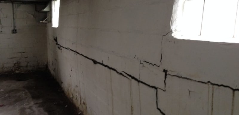

In Ohio most basement walls were unreinforced block construction until maybe the 70s or 80s. I assume that's the norm for anywhere in the US where basements are common. If the backfill isn't correct or proper drainage maintained, then the walls start to move inward years or decades later, with few good options to fix it properly. It's the first thing one should look at when buying an older home.
