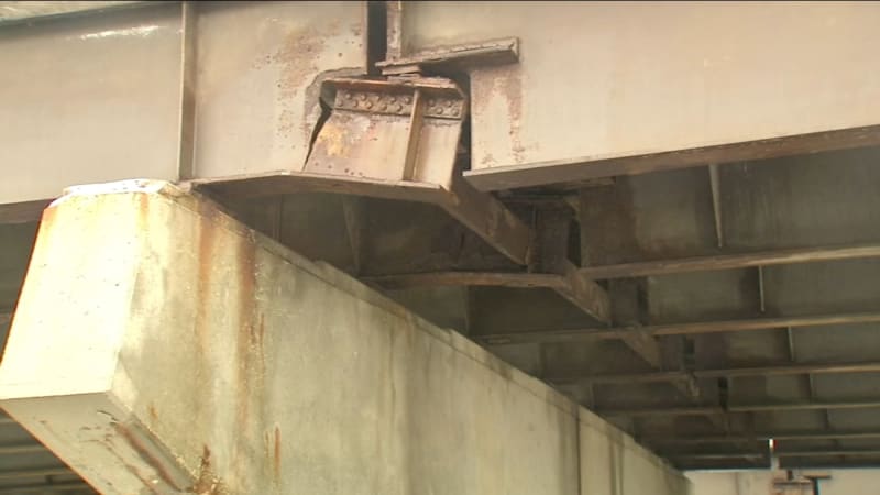

Northbound Lake Shore Drive Bridge (in Chicago) Closed For ‘Structural Emergency’

Built in '86 or 'modified in '86'?
I wonder when it was shimmed, that should have been a red flag right there.
Yes, when there's rust on the edge of the fracture - not a good look for the bridge inspectors.

For that connection to even work on paper it seems like there should be horizontal flanges/stiffeners at the seat, going at least the depth of the seat back into both beams.
Why do those shoring towers look like they're riveted together?

I thought that too Brad. The speed they appeared makes it likely they already existed just for that job. Did they have to fix this bridge before?
No way guys... those are pre-fabricated, modular, bolted shoring towers. You'd have to call around for towers able to carry these kinds of loads, but in a town like Chicago, they're sitting in some contractor's yard somewhere.
As far as temperature effects... most towers are flexible enough to not offer a lot of restraint/stability in the longitudinal direction. They're only there for vertical support. Presumably, the longitudinal load path wasn't affected by this failure.
