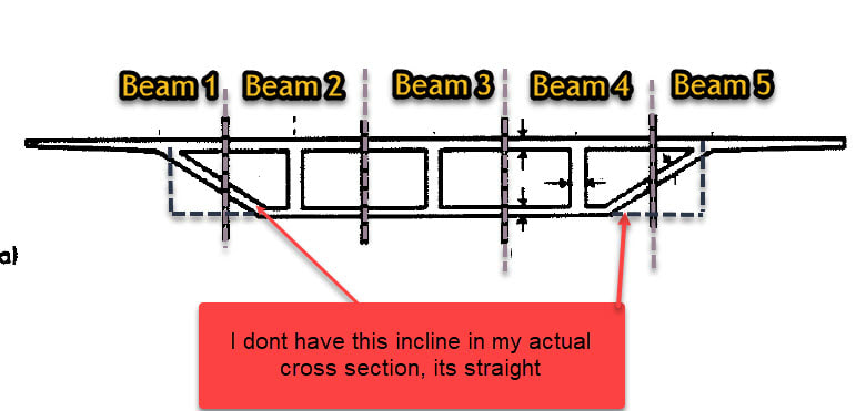

This is similar to how my cross section looks; there are 5 different logitudinal beams on which I have applied all the loads. The transverse or what I earlier called "dummy elements" are connecting them, they have no self weight. My computer model includes all the loads there are on the longitudinal beam, but I struggle to understand what transverse effect I need to think of?
You are attempting to design a concrete (presumably also post-tensioned) box girder with multiple boxes connected to triangularly shaped edges with an outstand slab to top it off. The model you are using for this - apparently a model of only the box girder webs, and with some sort of "dummy beams" representing the flanges of the boxes - is completely wrong. The load transfer between boxes cannot be represented by a "dummy beam" which transfers load into the webs from each tributary width. The transverse effect you struggle to think of is the fact that boxes do not behave identically to T-beams in a row, and even in T-beams or I-beams, torsion due to transverse eccentricity of load w.r.t. girder centroids is a mechanics problem which can be solved by e.g., influence lines or suitable computer models.
I recommend you to let your more experienced colleagues handle this design, or to change the design completely to a row of T-beams, since that design is easier and also more efficient if the bridge is straight and only minor amounts of torsion in girders is expected.
I don't recall which country you are from, but in our area engineering ethics requires we ask ourselves if we believe we are qualified for work we undertake. I studied this type of bridge in University, but not under an experienced engineer, so I would not undertake a project like this. If you do not have a mentor experienced in this type of bridge design I think you need to retain an expert. This is not meant to be rude, but this step is tripping you up, and this represents a very small part of the design.

Yes, the bottom and top flanges are not "dummy beams". They make the superstructure transversely very rigid. You'll get nearly complete moment and shear transfer. At the very least, it should be modeled with full continuous moment connection between the beams. To most accurately capture the actual behavior, it should be modeled as a single rigid cross section.
Your questions and modeling of this indicates you are well outside of your area of expertise. I again implore you to let someone with experience in bridge design take the lead, so that you can watch and learn.

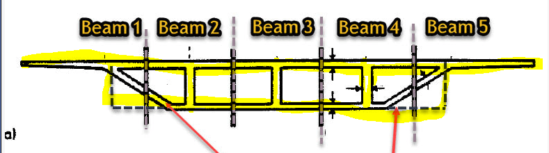

If your beam looks anything like the cross section that I have drawn below in yellow you model is completely wrong.
As said in some posts already, you have a box girder that supports the load with a combination of bending shear and torsion. I think that the shear center is somewhere close to the vertical wall below your label "Beam 3". Load from a vehicle on "Beam 3" will not cause any significant torsion on the beam while load on Beam 1 or 5 will maximize it. As please note, you don't have five beams, you have only one.
Based on your questions on this subject, you need more help that an Internet forum can provide.
