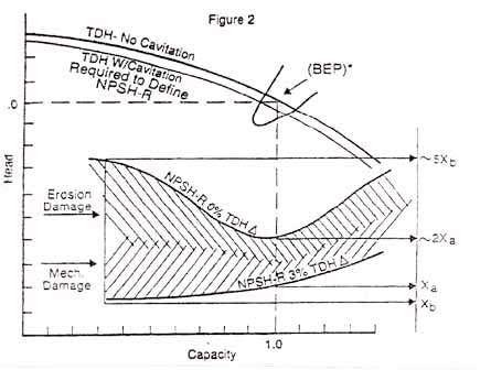

So a picture of your pump curve would be more useful.

If you ask the vendor nicely he might give you a graph of onset of cavitation vs flow and it might look something like this.
That's one of the best articles I've ever seen on the theory of NPSHR versus reality.
I learnt my lesson using a pump downstream of a vacuum de-aration tower. Even when I was within >0.5m of the NPSHR, the pump was audibly cavitating.
Pump vendor was good and eventually we came to the conclusion to use a bigger impellor and a 4 pole machine reducing speed to 1500 RPM. With the pump already in a pit I couldn't go physically lower but that seemed to work out OK.
They did actually provide the onset of cavitation curve and it was a lesson well learnt - NPSHR isn't cavitation.
