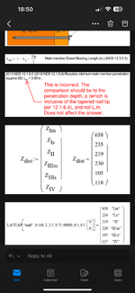

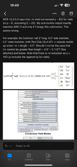

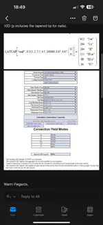

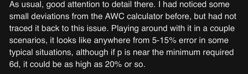

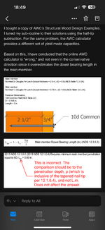

Terrible GUI but gets the job done.
I prefer to use my own spreadsheet
It’s a good calculator but has bugs. It gets certain applications wrong. I’ve emailed AWC about it.
I ultimately ended up writing my own Mathcad subroutine using the AWC Technical Note 12.
I keep meaning to post it for others to test and provide feedback. One of these days…
