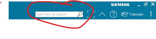

use the search to find commands

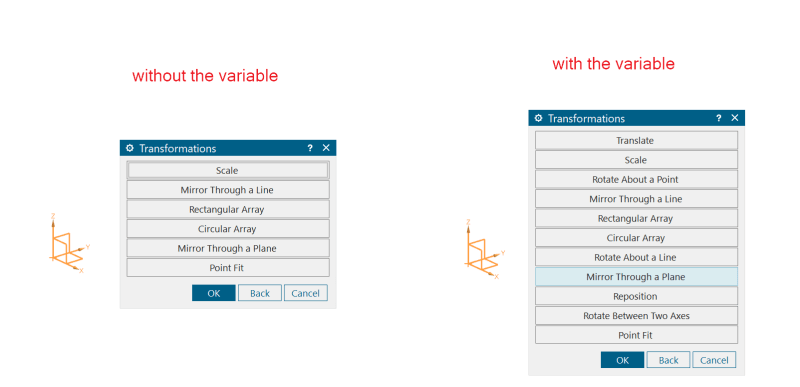

may be i'm very nostalgic but I still use the transformation command,
But if you want that it works like it was before
you have to add the variable
UGII_ENABLE_TRANSFORM_LEGACY_OPTIONS
and set the value to: 1
otherwise you don't have all the options (see the image)
