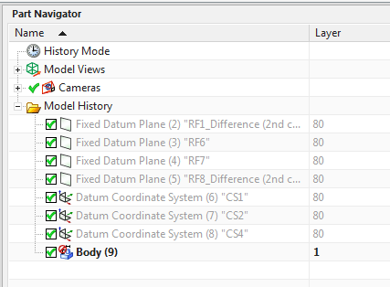

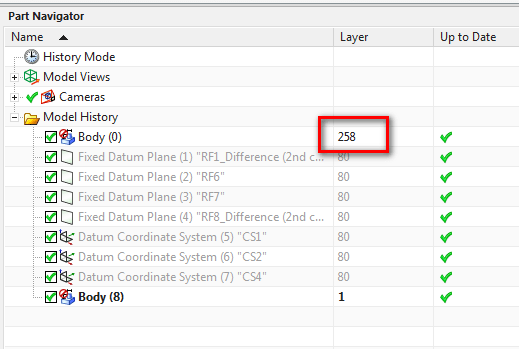

I noticed that there are more of such layers... The CMM tool (while converting)moves stuff to layer 258.
I also saw that there is a NXopen sample which moves stuff to layer 257. So you could do this yourself if needed.
CMM converted part in History mode.
After switch from history to history-free mode and back.
Ronald van den Broek

When we contacted GTAC, they wanted us to send the data into them to clean it. After going back and forth and waiting weeks to get our data cleaned, the above code is what was developed, We saw the bloat of our drawing in NX Version 7.5 or 7.0. Our drawings have been through the CMM process from I-Deas. So our drawings went from 23-30MB to 250MB to 23-30MB after we run the program above. huge improvements. We kind of narrowed it down to NX7 or NX7.5 time frame.
When the Drawing was CMM'd over the file size was fine, but when we did a saveas to a new revision the bloat happened.
