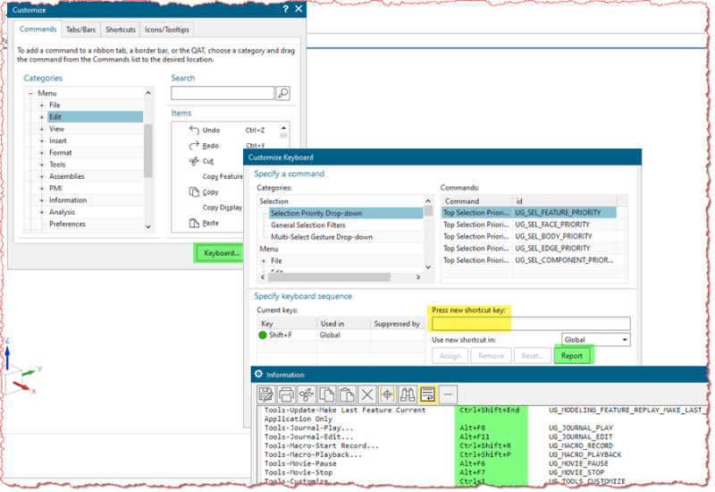

I do not know if you have seen this or not:
If you right click on any of the the NX icons you will see an option "Customize..."
then in the dialog that appears, there is a "Keyboard..." button bottom right. click that.
in the new dialog you can set new keyboard shortcuts for almost any function,
and you can click the "report" button to see a complete list of the shortcuts. ( Which I think is quite similar to your tips page ?)
And, if you set new shortcuts, save a new "user role". The "role" will store your shortcuts and allow for re-applying the shortcuts.
Regards,
Tomas
