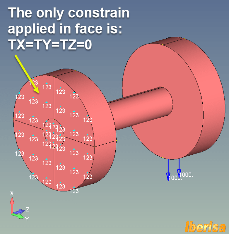

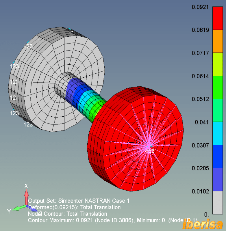

In fact, if I simply constraint the left face and apply a vertical load at the opposite free end face the model rotates.
This is the starting point:
And this is the solution of simply linear static analysis using Simcenter Nastran (SOL101):

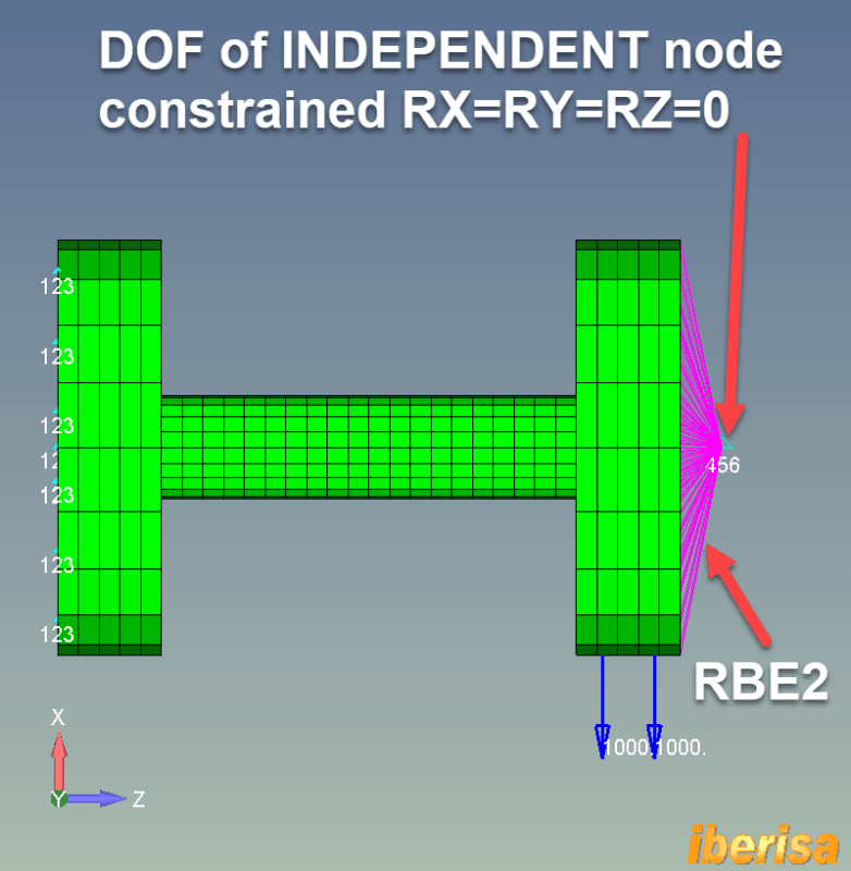

If the requirement is the right free end not rotation at all and NOT VALID to constrain the axial displacement (TZ=0) then the trick is very simple: 3-D Solid elements do not have rotational DOF, yes, then is useless to constrain rotations. But you can create a simply rigid RBE2 element using all the nodes of the right free face and constraint the rotational DOF of the INDEPENDENT node, and you are done!!
This is the starting point of FEA model REV1: only rotational DOF of independent node are prescribed (really simply RY=0 is enough)

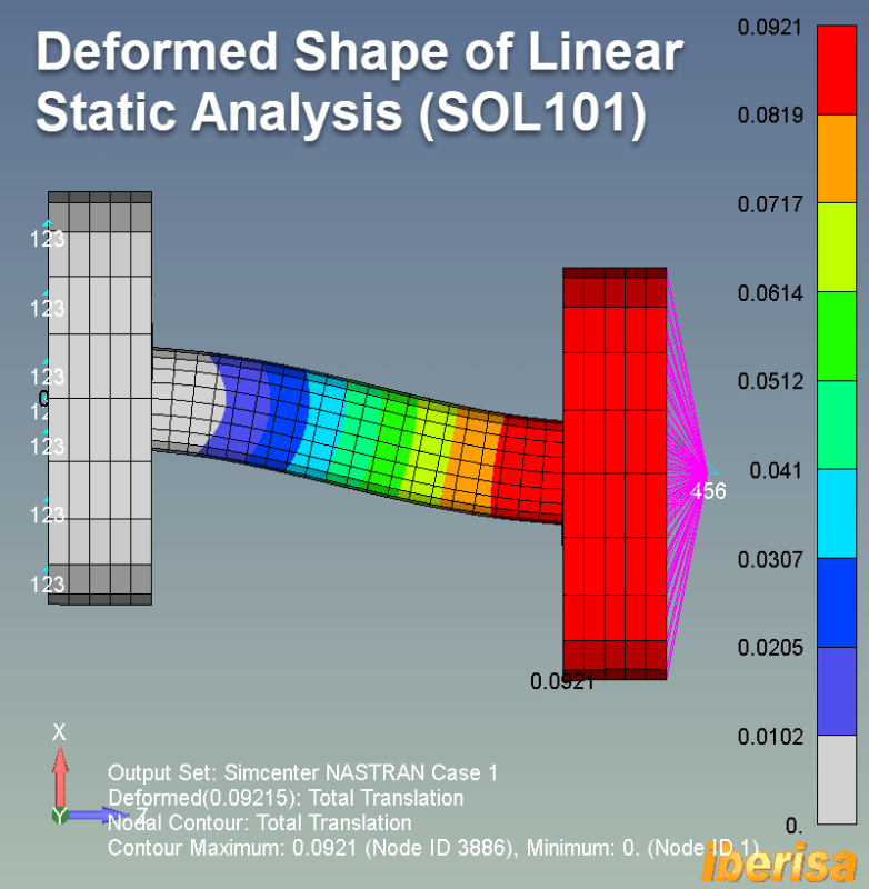

And this is the deformed shape of the linear static analysis with Simcenter Nastran (SOL101):

Thta's excellent Blas. I'd thought of using RBE2s or maybe a skin of shell elements on the end face but wasn't sure how.
