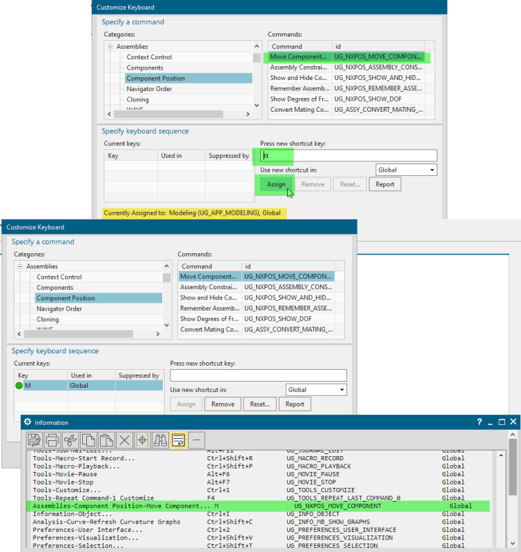

Why can't you overwrite ?
I do that all the time, find the command you like to overwrite, type the key and press assign.
in the picture I assign "M" to Move Component. Done.
