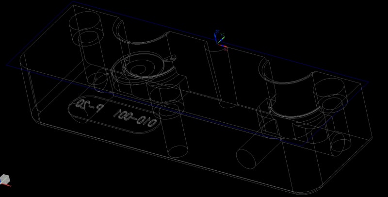

Hello,
Here's my scenario:
I have an insert modeled up.
I use drawing templates to create setup sheets.
Drag my template onto my model and it creates the drawings. Now the insert model is a child part of the drawing.
With my drawing part file set as the work and displayed part, and, while in modeling, I save a CSYS.
Go back into drafting and look at my views and the CSYS will not show up.
I've looked to make sure all the appropriate layers are on and visible, check to make sure it wasn't a 'reference set' thing but still no sign of the CSYS in my drawing views. I even tried creating curves (a simple box around the insert) and those curves won't show up either.
Any clue givers out there??

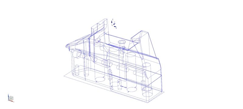

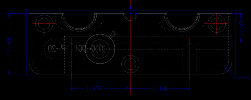

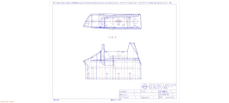

In NX 7.5 any curves I placed in 3D space (with the drawing files as the work and displayed part) I could get to show up in the 2D views simply by putting them on a layer and making it visible in the view.
As you can see in the images the CSYS and curves in my 3D-space IN the dwg.prt file show up in my views in NX7.5 Not so in NX11

For clarity, are you using the Master Model method? If so, when you create a drawing base view, NX now asks which of the loaded parts you wish to create a drawing. If you select the component, then you will NEVER see anything you do on the modeling side of the drafting file. I don't think NX did this in NX7.5 (or maybe prior). I do recall it changed at some point and when it did, it took me a bit to get used to it.
For example, let's say your insert is named INSERT.prt and you add that as a component to another file named INSERT_DWG.prt. When you have INSERT_DWG.prt set as the Work Part, create a drawing sheet and then proceed to place the first view using Insert Base View, NX will prompt if you wish to have your views reference INSERT.prt or INSERT_DWG.prt. Most of the time, it is preferred to choose INSERT_DWG.prt as the NX file to reference on the drawing. If you choose INSERT.prt, then whatever entities you create in INSERT_DWG.prt will never show up because you're putting them in the wrong .prt file. See if you draw the box around the insert in the model only file and add them to the appropriate reference set that they then show up on your drawing.
The bad thing is that I don't believe there is an easy fix to correct this - you will have to either remove all your views and add a new base view or just delete the sheet and start all over.
