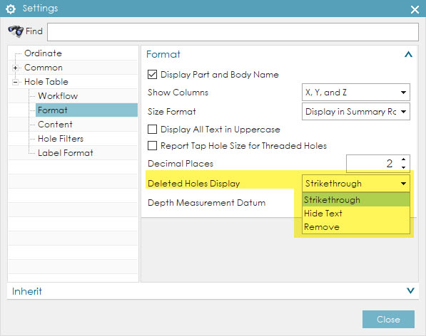

Good afternoon all, I have been working in Solidworks for about 15 years, but recently took a job working in NX. This is my first time seeing it. I have a question with the hole tables. Is there a way I can renumber, or reorder a hole table so that there are no sequence gaps in the chart?
(Ie. if hole D15 was deleted, then it will show hole D14, and D16 with D15 missing... how do I reset the numbering on the chart?)
