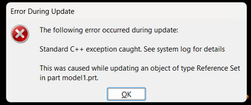

I allowed Dell Support to update quite a few drivers etc...
Now I get this error in NX when ever I try and open a part... screen shot attached

Turned out to be a video driver update that took place in the background.
Rolled it back and that fixed it.
