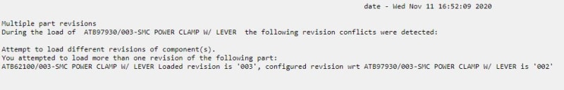

I tried to close all parts and open rev003 of that component first again. Then when I loaded the assembly file, it loaded but I got a message....
Then as I mentioned above, it shows the correct level 3 in the file and I can save it like that. But when I close all parts and open the assembly again, it is back to rev002. It makes no sense to me. I probably could have just deleted it and added the new one and rebuilt the spread sheet quicker, but a part of me just wants to figure out what is happening for my own knowledge. lol

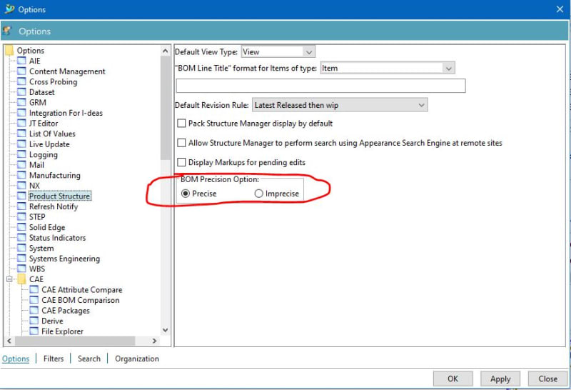

I did some looking up the Precise setting. Dont really understand it. This is our current setting...
Will this cause the problem? If I can look at our settings for NX11, will it be in the same place to see if that is different?
This seems to do with BOMs. Would it affect my assembly?
I'm not quite sure what the setting does in your screenshot.

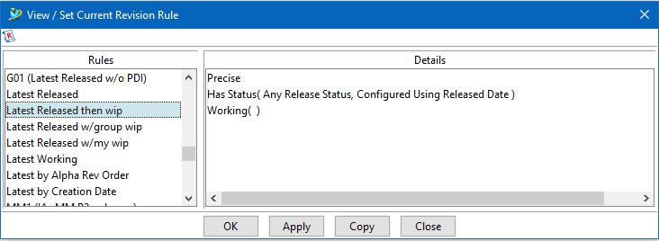

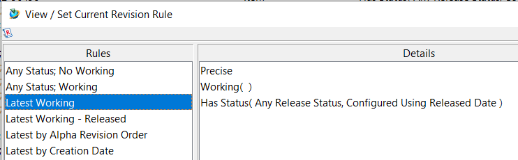

In TC, send your assembly to the structure manager; any item revs with a greenish background means that they have been saved precise. You can check your revision rules in the structure manager. Below is a screenshot from my setup (it was configured with the "rapid start" settings). You can see that the "latest working" first looks for components that are configured with the "precise" setting; if the component wasn't saved "as precise", it moves on to latest working, then finally any status. The load option rev rules will depend on your specific TC/NX settings.

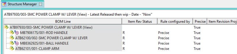

I figured out how to send my assembly to the Structure Manager. It seems to be showing that everything is made precise?
From what I am understanding, because it was created with the ATB62100 as Precise, it will not allow the assembly to change to a rev003 of that file? If that is true, is there a way to change the Precise setting so I can swap it out for Rev003?
Also....
I just had one of the designers send his assembly he was working on to Structure Manager and everything was Precise for him as well. Yet he could still swap out components for new revisions.
However, as a test, he added my Family Part template (rev002) to his assembly and saved the assembly. Then he tried to swap it for rev003 and it gave him the same error.
Could it be because we are adding the Family Part template and not just a particular component from the Family Part? Would that cause a stricter rule with Precise or something?

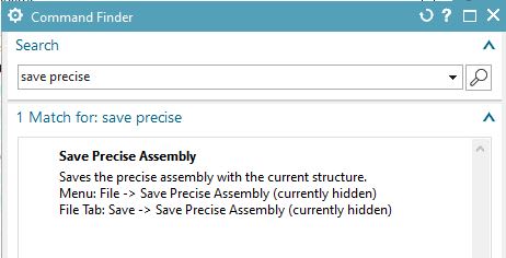

I have closed all parts and opened the Rev003 file first and then opened the assembly. It will show the rev003 in the tree then. I can save it like that.
Try using the "save precise" command at this point.
www.nxjournaling.com
Thanks cowski
That seems to have done the job. Took me a few to find the Save Precise as it was hidden, but after using that, I closed all parts and opened the main assembly and it had the Rev003 file in there. I really appreciate the help.
I wonder why "save precise" is hidden by default.
I did a search with the command finder and mine is hidden too.
