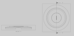

Hi @cowski,
With your suggestion now we are able to select the curve and with the Journal code able to get the section view however the view 90 deg rotated.
Our left view is based on co-ordinates Y and Z and we are using select screen Position method to get the location for the section view from the user.
response = theUI.SelectionManager.SelectScreenPosition("Select the section view location", out View, out loc);
But the co-ordinates we received from the above method is of screen position XYZ and our origin (0,0,0) is the center of the left view.
Any pointers on how we can get this right?
Thanks!
I don't entirely understand the issue from your short description, but it sounds like you want to select a drafting curve with .SelectTaggedObject, then select a location on the drawing sheet itself with .SelectScreenPosition in the same journal. If so, be sure to use .SetCursorView(1) before the SelectScreenPosition call to limit selection to the work view, which is usually the drawing sheet itself (you may need to check/change the current work view in code).
If you are selecting a point in the model and want to know the location on the drawing sheet, you can use .MapModelToDrawing. Use .MapDrawingToModel to go the other way.
Sorry if I was not clear earlier and Yes your understanding is correct. To give you a background we are generating left and section view for a model. We created a journal for the same and currently trying to replicate the functionality in NX open through windows form submit as need to collect few other details from the user. Once the left view is created on form submit we are prompting user for the section view selection and the position for the section view on the drawing sheet. Section view is created however is rotated 90 deg. We are using cursor point3d value from the .SelectTaggedObject method for the selected drafting curve as our section line path and the point3d value from .SelectScreenPosition method as location for our section view.
The issue is section view generated is 90 deg rotated, the cursor point3d value from .SelectTaggedObject has value from origin which is center of our left view however .SelectScreenPosition has point3d value which is way different (or way above) from cursor point3d value.
Attaching image for reference.

Hi @cowski,
Can you help with this? I'm trying to create a section view using NXOPEN api when I select a circle through UI selection manager the section line is NOT passing through the center of the circle. Currently I select 3 different circle through which I want the section line pass through all its center but it connects through only one center as shown. How do I make it to pass through center of all selected circle?
Any help is appreciated.
