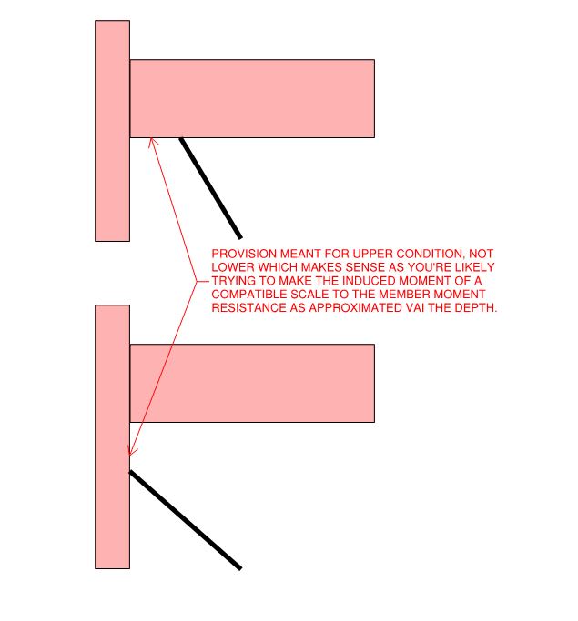

An ordinary concentrically braced frame (OCBF) was designed in SDC D with 1/2" diameter steel rod welded to a plate and bolted to the face of a HSS4x4x1/4. The baseplate is attached to the concrete with 3/4" epoxy anchors. See the picture below for a sketch.
The detail shows a 3" offset from the baseplate to the bolt hole to maintain an eccentricity less than the beam depth as specified in Section F1.2 of the Seismic Provisions. Because the column is bolted to the foundation and there is no beam, 3" was deemed reasonably less than the 4" column depth.
Due to field issues, the contractor requested this 3" be increased to 6". The columns and base connections have no problem with the increased eccentricity.
The question is, at the base of a column, what is an appropriate allowable eccentricity given there is no beam?
Thanks in advance!

It's definitely fair game for interpretation but my inclination would be to follow your original assumption: max eccentricity = 4" = column depth. My read of the provision is that the eccentricity is meant represent a connection point offset horizontally along the beam, not one offset vertically along the column (extremely rare anywhere other than at the foundation). In your case, I think that it's most analogous to be treating the column as though it were the beam affected by the eccentricity since it is my expectation that the goal is to enforce some kind of compatibility between the resulting member moment and the member capacity (indexed to member depth). That goal only makes sense in your situation if the column depth is what is being compared to the eccentricity.
All that said, I consider OCBF design to be pretty much free for all, cowboy country where you can do as you please so long as it's rational and the numbers check out. I'd not sweat this myself unless I feared a challenge from an A-game AHJ reviewer etc.

JAE - Yes, my initial thought was to keep the eccentricity to a minimum. 6" does not sound unreasonable to me but I want to make sure we are at least meeting the intent of the code. And yes, the rod is through bolted to the face of the HSS4x4x1/4. This does create an eccentricity of 2" but was accounted for in the anchor design.
KootK - Those were my thoughts as well. The intent of the code is to limit the eccentricity while accommodating the connections. This is an unusual structure with light loading and tons of redundancy. I appreciate your practical approach to the problem. Since this is a modification, I am not sure how much scrutiny there will be.
BAretired and strucbells - The brace has an eccentricity in two directions because it is through bolted to the face of the column. The forces in the braces are around 3 kips (ultimate but without over strength) so they are relatively lightly loaded. This small eccentricity was factored into the anchor calculation. Ideally, the brace would connect to a gusset plate. However, due to some wall framing that is in line with the framing, it was not possible to install braces with a gusset plate at the center of the column. Also, the steel is hot dip galvanized so welding at this point is not practical.
