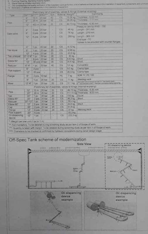

Anybody has expeiance in "Off-SPEC TANK" with the oil Dispencer Device?
About Design criteria and reference for designing and manufacturing...
Do you mean the floating auction device?
Try searching for Floating Suction.
This is a common device used in many tasks to take product from the top 1m, mainly to avoid water or dirt which is at the bottom of the tank.
Also, try a search for "Oil skimmer pipe", which turns up this item: I'd say, generally, a floating suction is to withdraw the cleaner oil out of an oil tank, and oil skimmer is to get oil pollutants out of a water tank.
Dear all,
Thank you very much for giving me your wonderful advice.
The mentioned term of " Oil Dispensing" Proposed by client may not correct.and " floating auction device " is the correct term
for such a services
