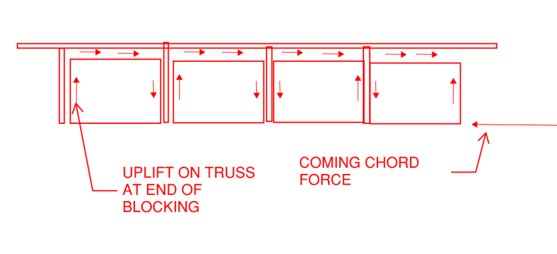

8) At each of the drag trusses bounding the transfer diaphragm, the shear blocking will deliver an uplift load into the truss that may require hold downs into the wall system.
With all of that in play, one starts to wonder if such a fantabulous kit of parts actually possesses the stiffness to do the job that we're assigning to it. Moreover, in a lot of the buildings that I deal with, we'll have jogs like this every 30' or so. So you'd wind up doing this chord splicing voodoo for much of the length of the building.

6) This doesn't bother me. Intermittent blocking can still transfer compression. Depending on workmanship it won't be quite as efficient, but it still works. The coil strap is there because the blocking is intermittent and can't transfer tension. Or am I misunderstanding your meaning?
You must be missing my meaning. The shear blocking that's not over the top plates is basically a segmented column in compression, not shear lug-ish as over the top plates. The only way to transfer compression across intermittent gaps in the blocking would be by using the tension straps or the sheathing in compression, both of which sound sketchy to me.

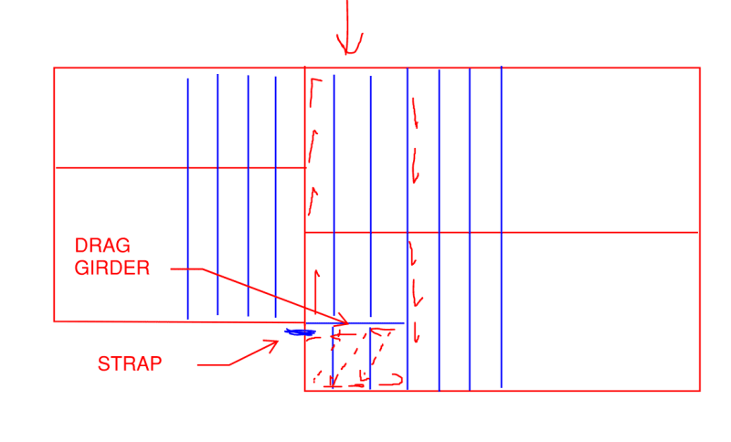

In my market, the chance of this getting installed properly or even at all is slim to none. Most of these framers cannot read plans and have little if any oversight from the GC. I feel like the KISS method is always best in residential. My go to would be try to use 3-sided building principals. If it means sheathing some interior walls, then so be it. Much easier to get that done correctly than some piecey blocking detail.
If one were serious about the getting the chords spliced, I'd think that you'd need to do something like I've shown below. But, then:
1) You'd need adequate depth for that girder and;
2) You'd likely be shot. Folks don't take kindly to "sport girders" from a gravity perspective.

phamENG said:
Adding extra spaces simplifies design, installation, and inspection.
No doubt. But, then:
1) The longer you make the thing the less effective it gets from a stiffness & effectiveness perspective.
2) A ten space blocked drag strut is exactly the kind of thing likely to lose me work in my market.
phamENG said:
Are we talking about leaving sections of blocking out or just the 1/8" gap at the end because the day laborer put the kerf on the wrong side of the cut line?
Leaving sections of blocking out. Is that not what is normally meant by "intermittent blocking"? The 1/8" gaps also bother me a bit in terms of the compression slop that they'd add but, given all the other issues, I wouldn't sweat that.

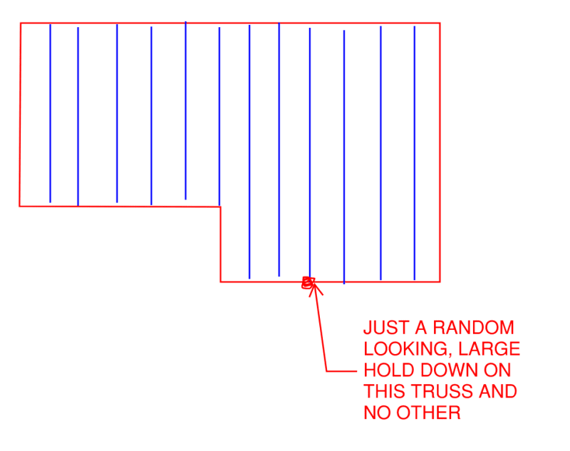

There's nothing unique here.
I say that there is something unique here. In Florida, I'm sure that every truss would have serious hold downs and that adding some tie down capacity to the drag trusses would be opaque. Where I'm at, the situation would be more like I've shown below where I'd be attempting to add one lone hold down in a field of other trusses that don't have them.
phamENG said:
As long as those loads are provided to the truss manufacturer, they'll show up as an uplift end reaction, and they'll get a hold down that is (hopefully) sized to resist it.
In 20+ yrs of practice, including several as a truss manufacturer and industry rep, I've not once ever seen anyone provide these uplift loads to a truss manufacturer. Not ever. Have you?

KootK said:
Leaving sections of blocking out. Is that not what is normally meant by "intermittent blocking"? The gaps also bother me a bit in terms of the compression slop that they'd add but, given all the other issues, I wouldn't sweat that.
Okay, we're on the same page about the blocking.
KootK said:
I say that there is something unique here. In Florida, I'm sure that every truss would have serious hold downs an adding some tie down capacity to the drag trusses would be opaque. Where I'm at, the situation would be more like I've shown below where I'd be attempting to add one lone hold down in a field of other trusses that don't have them.
Fair enough. Probably another case of a webinar for city inspectors, uplift load path became a big thing here about...10 years ago? Something like that. EVERYTHING at the roof gets tied down. It's just a matter of identifying the size/capacity of the connector. Below the roof, however...well let's just say the roof will now take the house with it.
KootK said:
In 20+ yrs of practice, including several as a truss manufacturer and industry rep, I've not once ever seen anyone provide these loads to a truss manufacturer. Not ever. Have you?
Yep. I've gotten some confused calls from truss manufacturers. One of my first designs after starting my solo operation I almost got burned because the truss manufacturer missed a line load on a floor truss system. I was only saved by an architectural design change that clued me in to construction progress, and I was able to redesign the roof structure along with the architectural change to move the load elsewhere. Since then I've been pretty particular about listing everything that might load a truss very clearly on the drawings.

phamENG said:
Yep...Since then I've been pretty particular about listing everything that might load a truss very clearly on the drawings.
I wasn't asking "have you specified some unconventional truss loads?". That's no big deal. Rather, what I was asking was whether or not you've specified truss uplift forces originating from the demand for overturning resistance in shear blocking systems? If you have then, by all means, please post some snips of the areas in plan and how you've handled the specification of the loads. That way I can have them framed and hung next to the pictures that I have of the unicorn that I ride into work and the sasquatch that sneaks into my hot tub during the winter months.
Touche. I haven't needed to specify that particular load. But if it comes up, I'll send you a copy of the drawing. The architects I'm working with are doing a lot of hip and flat roofs, so I'm not getting steps like this very often. And the one that does have it on my desk now is a stick framed roof, so no loads to spec to a truss engineer.
