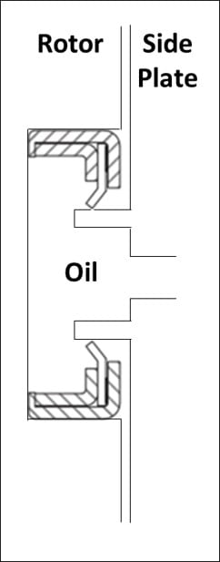

I think I may have found a solution using pairs of concentric lip seals such as the Parker FlexiCase CMN Series seals which are good to 6,000 fpm. These type seals are, however, intended for use sealing a shaft not one rotating plate adjacent to a stationary plate, so I may have to be clever and use concentric pairs of seals riding on surrogate shaft surfaces as shown in the concept drawing below. I'm still working my way through it to confirm it can be made to work and, if so, how much space it will consume.
Rod
EDIT: I already see the first problem... the top seal as shown would need to be an outside seal, and I don't think they're available in the FlexiCase Series. Hopefully they're available in *some* series.

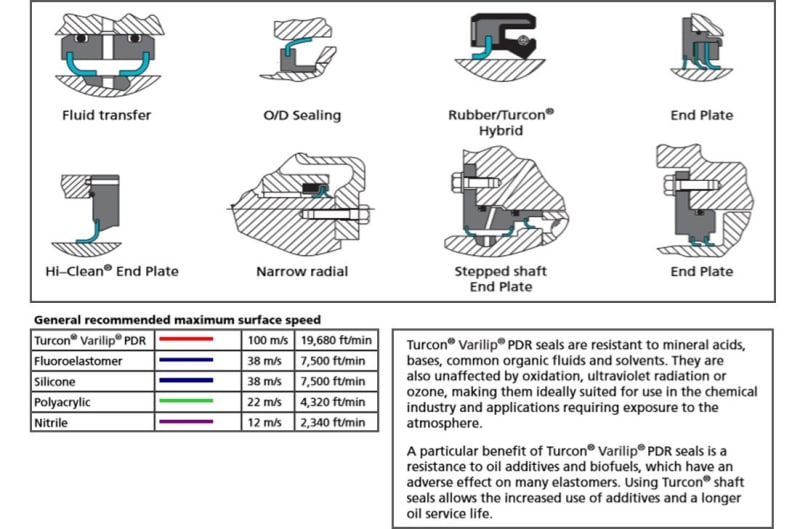

The Turcon Varilip PDR Series may work better. Note they go out to 170mm (6.693") in the metric table but only 4.125" in the inch sizes. I particularly like the "Fluid transfer" arrangement as it may use less radial space (I have plenty of axial space). They sell these seals for both inside and outside sealing, so they also support the arrangement I showed in my prior comment.

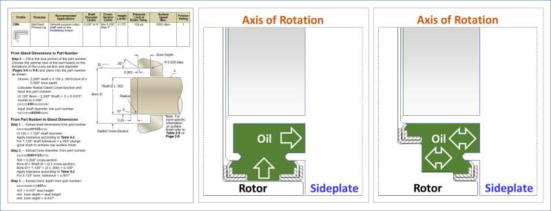

This solution is simple and low cost yet meets all requirements and consumes less space than the o-ring solution.
In this approach, standard seals which are normal stationary and sealing a rotating shaft are instead rotating around stationary circular manifolds extending into the rotor from the stationary side plate. I don't believe the approach violates any of the functional requirements or capabilities of the seals. Though I flip one seal relative to the other, I see no mention of sensitivity to rotation direction in the selected seal's literature.
The center illustration shows the preferred arrangement in which the side plate manifold is most rigid, identical seals are used, and the rotor cavity is simple. This configuration, however, requires additional radial space to route oil between the seals. The arrangement shown in the rightmost illustration is less desirable due to lower rigidity, use of different seals, and complexity of the rotor cavities, but it incorporates space for axial routing of fluid between the seals and is thus the preferred for the outermost oil return seal.
The seals are from Parker's Flexicase CFN Series. The seals are a nice fit to my needs because they're fast (6,000 fpm), operate at high temperature in the presence of oil (up to 600F), and have a small profile (0.250 high x 0.175 wide). The largest risk in this approach is the requirement for 0.005 dynamic run-out on the "shaft." To mitigate this risk, I will switch from the 6202 main bearing in the rotor to a 7202 precision bearing and match-bore (stack and clamp the parts then bore all together) the central axis of the rotor and side plates. Another risk is in my interpretation of their specifications in terms of profile height and width and my assumption I can get these seals in any arbitrary bore and shaft diameter insofar as they're under 6.00 diameter and comply with the 0.250 cross-section limit. To address this risk, I'm contacting my local distributor to find out what parts are actually available for folks like me who need only a handful.
Does anyone see any issues with this approach that I've missed?
