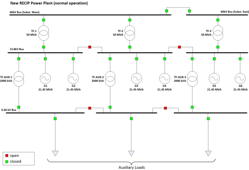

Hi Bill,
Thanks for the reply.
Below you'll find a high-level schematic illustrating the situation.
With operation philosophy, I was referring to the procedures that the operator would take to manage the OLTC operation.
For example in what situation is the operator to use the OLTC? I understand it should be in close coordination with the generator output to the grid, but when shall the operator decide to use the OLTC for reactive power compensation to balance the grid voltage?
Thanks in advance for any information.
The 13.8kV bus voltage is reference to the Generator AVRs I suppose. In that case, the generator AVRs will try to maintain the 13.8kV bus voltage constant under varying load conditions. If you like to maintain power factor, I suppose the generator AVR will also have an option to select power factor mode and this suits better for captive power plant serving loads of a specific industry.
The transformer OLTC operation is not required / not desirable as long as the generator AVR is able to regulate the voltage.
If the variations are beyond the AVR range of generators, the transformer AVR can be set to come alive based on the trigger that says the generator AVR has reached its limit of regulation.
The other option is choosing dead band of transformer AVR beyond the available voltage range of regulation in generator AVRs. This ensures that transformer AVR cuts-in only after the generator AVR reaches its limit.
Just a few thoughts for you to work on, based on your specific requirements.
Generally speaking, Generator step-up transformer OLTC is manually operated in grid connected power stations.
Further to RRaghunath's post.
The generators will be maintaining the set voltage on the 13.8 kV bus in order to deliver a stable voltage at the 460 Volt bus.
Adding a tie to the grid, you will need OLTCs on the transformers to match the grid voltage and track changes in grid voltage.
Your agreement with the utility will generally include limits on the power factor and you will need the OLTCs to stay within the limits as the grid voltage changes.
You will not be able to control real power flow with the OLTCs.
Real power flow is controlled by the throttles or fuel rate of the prime movers.
As you go on-line and ramp your co-generation contribution, you may have to adjust the OLTCs to keep your PF between the allowable limits.
