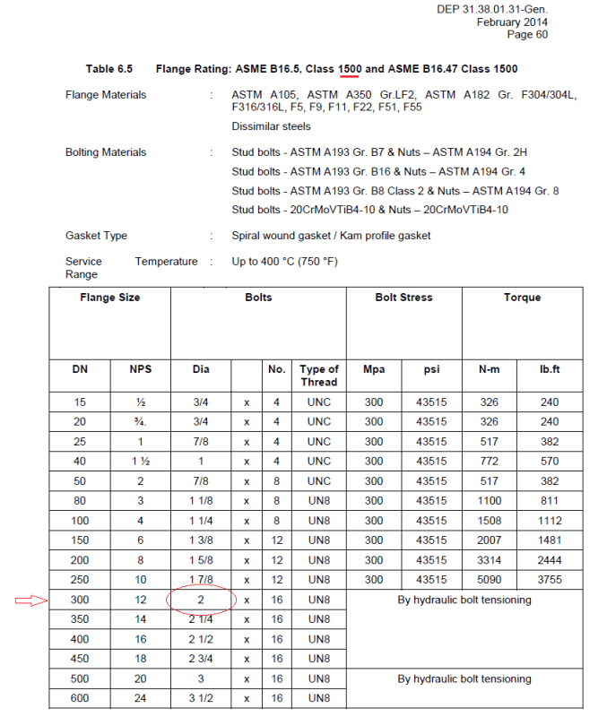

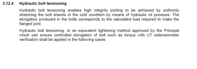

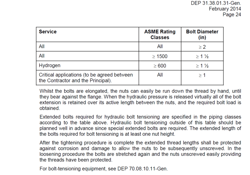

What is the criteria for applying hydraulic bolt tension? In shell DEP 31.38.01.31-Gen article 3.12.4 specify hydraulic tension for bolts larger or equal to 1.5" , while in appendix 6 of same document puts hydraulic tension at 2" and above.
On a second note the tables in appendix 6 does not specify any values for bolt tensioning, where can we specify these values .

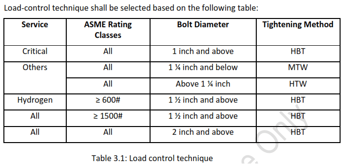

i couldn't find any standard on hydraulic bolt tensioning but here is a good info on the calculation: Link
also there is a discussion in this forum: Link
Also, here is the standard from Petronas (Bolted Flange Joint Assembly PTS 12.00.06):
MTW = manual torque wrench
HTW = hydraulic torque wrench
HBT = hydraulic bolt tensioning

@littleinch bolt tensioning is common on all oil and gas specially when bold dia goes more than 1.5inch.
@BEMPE16524 , dear R.Efendy , the table is similar to what Shell DEP says in 3.4.12
and here is the conflict,the table you shared also indicates HBT to be done for ratings 1500# and above when bolt size is 1.5" and above, but appendix 6 puts the HBT for these ratings still for bolts 2" and above:
so shall we use HBT by following the 1.5" or 2" limit ?
Specification conflicts ought to be resolved with the author (company) of the specification. IN fact, at the start of the specification, there is usually a conflict resolution mechanism. Follow that.
i guess it is up to the client to decide.
sometimes it is purely depends on historical experience due to cases such as accident and some updates are not tally with the reference.
as you can see from the ASME table, the suggestion for HBT is higher (2") and in DEP and Petronas PTS, the requirement is lower and i'm pretty sure they have studied the reason.
