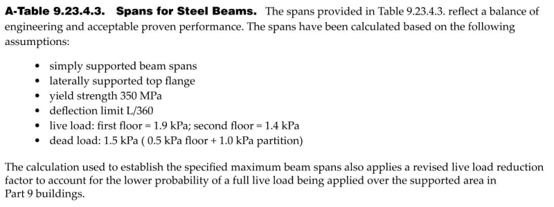

Hi Guys,
Just wondered if any of you can shed some light on the steel beam tables provided in Part 9 of the Ontario Building Code.
I'll take a simple example:
According to the table a W8x18 steel beam with a 19'6" tributary width should be able to span 19'.
Beam is assumed to be laterally supported with typical residential loads applied (10DL and 40 LL) PSF
When i run the calcs i get some major failure in deflection (over 50%). I can't figure out what reduction factors are being used and what is the rationale. This is especially an issue if I start stamping drawings where architect uses these span tables yet I think they are not compliant with Part 4 of the Code (using engineering calculations).
If anyone can provide any insight here would be much appreciated.

Check the commentary (A-Table 9.23.4.3) for the derivation of the span. Copied here for convenience. They use a "revised live load reduction factor to account for the lower probability of a full live load being applied over the supported area in Part 9 buildings". I've calc'ed out the table (it might be a previous thread too...) and come to the same conclusion as you. Most are within tolerance for capacity, but the deflection significantly exceeds allowable. It's a pretty hand-wavey method for Part 9 to use a revised load reduction factor without stating what it is.

Assuming this supports only one floor, using the code prescribed live load reduction in part 4, you can reduce the live loads 17%. If it's a two storey, with the trib areas indicated, you can reduce it 32%. So there's likely some room there as well.
