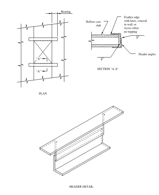

You can find a Hollowcore Manual on the PCI site (pci.org) that discusses openings and load transfer. When you have a large opening across a slab you will often see steel transfer headers across the opening that bears on adjacent slabs, particularly in shear critical areas.

Generally I don't see any problem with their proposed steps but would agree with cooper that with large openings you need a steel transfer header; but that could definitely be installed after cutting the planks. PCI hollow core slab design manual would be my go-to reference here and it has references for shear key capacity. Edit: I see that you couldn't find the reference. I believe it's in section 4.6.1 but my hollow core manual is older so it might have moved.

If they cut across the entire width of the plank I would expect them to use a header, below is from PCI hollow core manual.

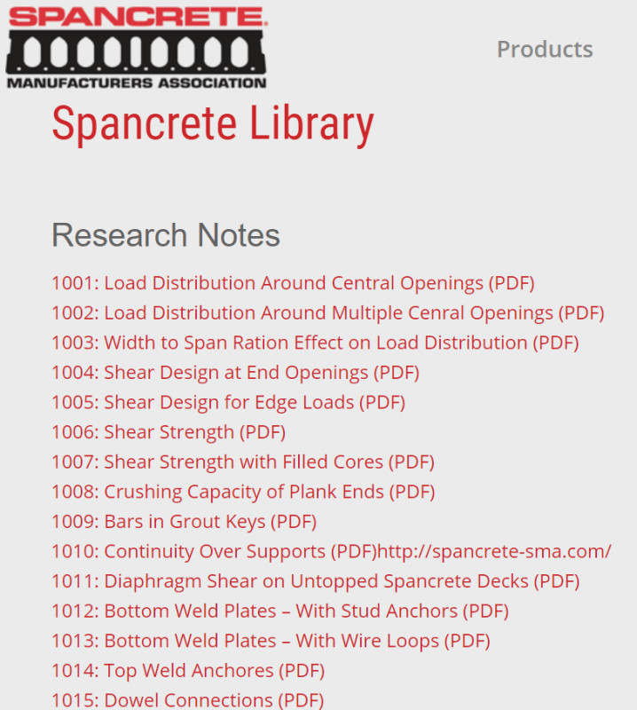

Spancrete Manufacturers Association have a bunch of free research/testing info on various hollow-core topics: Link
I am not sure if it has a direct topic that covers your specific problem, but a good resource, none-the-less.

The keys to understanding when steel headers are necessary are these:
1) Is it needed for erection of the planks and;
2) Given that keyways don't generally transfer moment, is it required for the equilibrium of any planks in the finished state?
EZ said:
the cantilever moment and torsion on the remaining section would likely become a significant deisgn challenge.
If either of these things is true, plan for a header. If not, expect your precaster to push pretty hard for not having a header.
