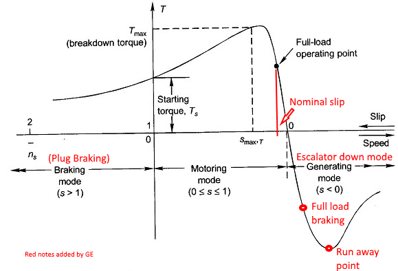

I am interesting about operation of asynchronous engine in escalators moving down. Is the engine working as generator? If so, can an overload beyond maximum couple cause an escalator overspeed? Moreover, in generator operation, is the energy lead into grid or dissipated in a rhesostat? Thank for attention
The Asynchronous motor tries to run close to synchronous speed. A four-pole machine (on a 50 Hz grid) that is 1500 RPM.
But it doesn't run exactly at that speed because it needs some "slip" (difference between synch and actual speed) to have enough rotor current (induced in the rotor bars) to balance the load torque. So a motor that is "motoring" as opposed to braking, will always run slightly below synch speed. And the slip increases as load increases, there is a drop in speed when load increases.
In the braking mode (which seamlessly and without change in anything but the load torque being opposite) the motor speed is just above the synch speed. The slip is negative, so to speak, and instead of drawing power from the grid the motor delivers power to it.
The torque/speed curve is symmetrical around 1500 RPM and it is all very simple, actually.
Study the picture below (found on the internet, thanks to unknown)

Usually it would be sent back into the grid when large loads are going down. Buildings big enough to require escalators can easily re-consume the escalator power. There has to be some sort of backup in case the grid becomes unavailable. The escalator VFD will remain powered as long as the load is descending but will still need somewhere to dump a lot of energy if the grid becomes unavailable. Likely this would be solved by an electrically held-off mechanical brake that simply friction stops the escalator into expensive stairs.

Ok, my question is: if |T|>|T|Run away poin, is the motor accelerating, also if is it in generating mode?
@itsmoked Motor not engine....
Of course :-)
Yes, the machine will accelerate when the load torque magnitude exceeds the runaway torque point magnitude, which is the maximum torque the machine can put out when operating as a generator.

I have a bit of a problem with the picture.
The curve is a typical curve for a DOL induction motor.
However the normal operation of a VFD is in the region between the full load operating point and the full load braking point.
To start a motor with a VFD frequency set so that the motor is at the point shown as the starting torque is wasteful and does not take advantage of the reduced starting current of the motor VFD combination.
To say this another way, that picture/curve and the operating points shown are valid for an induction motor started DOL.
Normally the limits of VFD operation will be between the breakdown point and the runaway point or between the current limit points if set, for short periods of time.
Steady state operation or load RMS* operation will be between the full load operating point and the full load braking point.
*Link See .pdf pages 49, 50, 51. RMS HORSEPOWER LOADING
Comments?
A question for Gunnar and Jeff:
It is my understanding that that curve may be used for VFD operation if the 0 point is the VFD output frequency and the slip is the motor normal slip.
eg: 1800 RPM - 1760 RPM = 40 RPM slip for a 1760 RPM motor
1500 RPM - 1460 RPM = 40 RPM slip for a 1460 RPM motor.
Is this correct or close to correct?

Most escalators do not use VFDs, there is no value in varying the speed. Most use Across-the-Line (DOL) starters or at most a form of Soft Starter that reduces the voltage when the escalator is unloaded (Nola energy saver circuit), but only IF the escalator must be running all the time regardless of use, as in airports and 24/7 facilities like casinos. In places like large retail stores where the escalators are not used when the store is closed, they don't even bother with that, they just use ATL / DOL starters. As far as over speeding, the motors are connected to right angle worm gears with a very high gear ratio, so they are not really subjected to a lot of regen force anyway. They are basically motoring regardless of going up or down, there is just a lot less motoring needed going down.
If a down escalator's load rating is exceeded so that the motor overloads or if the line power is cut off, a mechanical safety clutch/brake engages and stops the escalator. It does so slowly so as to avoid making any passengers fall forward and end up in a pile at the bottom. So no matter what, the escalator cannot over speed. But the motor size / gearing is such that you could have 300 pounds on each and every stair tread and it would not be enough to over load that motor.
