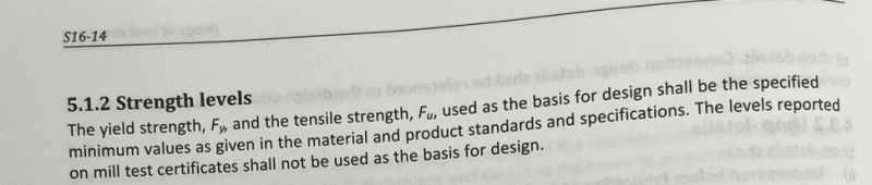

Snippet from CSA S16-14.
Aaaaand we have a winner.
