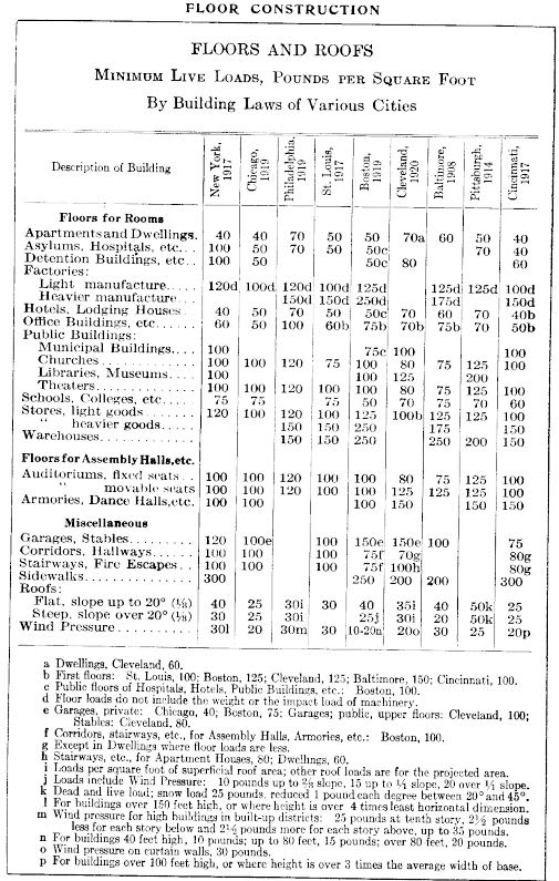

I am looking for reference(s) that provide logic behind the magnitude of floor live loads provided in the building code. For example: How was it determined that corridor floor live load is 100 psf or hospital operating room is 60 psf and so on. Appreciate the help. Thx.

The live loads have been about the same since "Minimum Live Loads Allowable for Use in Design of Buildings", U.S. Department of Commerce, November 1, 1924. A scan is out there somewhere, should be findable via Google. I don't think it has any commentary though.

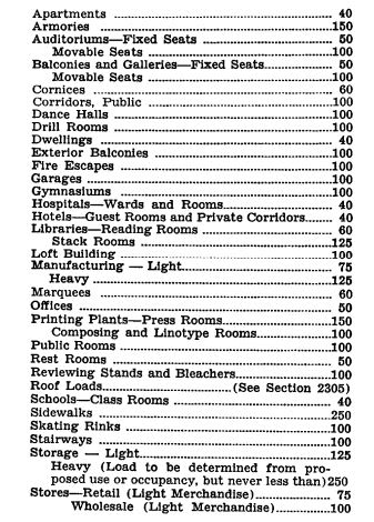

These don't explain "WHY" they are what they are but thought I'd post them.
1923 Carnegie Pocket Companion:
1946 Uniform Building Code:

The 1916 NYC code uses very similar loads to what we use today. Simpler times back then. But I don't think they have much commentary in there about it so the typical 40, 50, 100 psf loads were from before that time at least.
