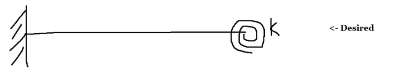

I have a question about out-of-plane loading on an L-shaped beam, or a two-member frame, with fixed ends.
The problem I am working on is shown below:
I can find resources on how to find the reactions and moments due to the FY forces but I am unsure how to find the reactions and moments due to the FX forces (out of plane).
Both beams in this scenario have the same I values. The FX1 and FY1 forces are acting at the same point and the FX2 and FY2 forces are acting at the same point, if it isn't clear.
I would greatly appreciate it if somebody could point me to a resource that explains how to solve this, or if anyone has any ideas on how to find the reactions and moments due to the FX forces.

For FX1 and FX2, you could try applying the principles of determining the load split by equating displacements and rotations for the two beams on each side of an applied load. At the fixed ends, you will get reaction forces in the x and reaction moments about Y and Z (at FX1, moment in one beam will be seen as torque in the other). There are other elastic beam theories you could try.

There may be value in treating it as a single cantilever with a spring equivalent to the removed beam for each cantilever, evaluating for both and then comparing with a FEA solution. It's not something I've looked at in a long time so might be off base. May be others can confirm or challenge. The following are examples of potential interpretations rather than recommended solutions.

The equivalent spring would be a rotational spring (based on the removed beams bending stiffness) rather than the direct linear spring of the previous links. The effective spring constant applied to the end of the cantilever might be K=3EI/L^3

it would help if you maintained a sigh convention ... FX1 is +ve in the -ve X direction.
Fy ... a small amount of Fy will be reacted at the base of the vertical leg ... depending on the deflection of the horizontal leg (under tension) ...
equate the tip deflection of a cantilever with a tip load dY with the tension deflection of the horizontal beam under Y1+Y2-dY.
Fx ... similarly equate the tip deflection of the vertical cantilever under a load of FX1+dX with the deflection of the horizontal leg.
