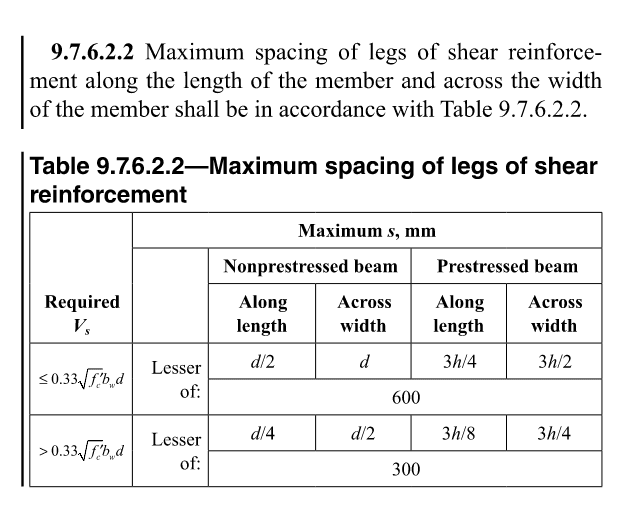

I think I have to make the question more clear. There are total 3 types of overlapping hoops in the attachment.
The one in the top where I mentioned "2 consecutive rings" is the detail used by the other engineer. The problem here is this type of overlapping doesn't have any intermediate leg to resist shear when the crack travels inside, all the legs are at the edges. Whereas the remaining 2 details in the bottom (From ACI) are the ones I use for the opposite of the above stated reason.

Whether or not this is an issue will depend on the width of your beam and what code you're using. Some codes have limits on the transverse spacing of stirrup legs. IIRC, ACI added this fairly recently.

I wouldn't consider any any of the configurations the OP showed to have lapped bars. They all have hooks. All 3 have fully developed shear reinforcement. What the first (top) one doesn't have is any internal legs to reinforce the core. I haven't seen the research to show why, but per the table KootK posted, it appears not having a large cross section of unreinforced concrete is important.

There is slightly less steel running horizontally across parts of the top and bottom in the second configuration and depending on the size of the bar shown in green in the illustration, potentially a much smaller amount across the top in the 3rd configuration. However, as Tomfh noted, the situations where this would matter (high torsion) would be very rare. Mostly, it's the vertical legs of the bars that matter. In respect to that, the configurations at the bottom of the illustration are apparently better, since some of the vertical legs run through the core of the concrete.
