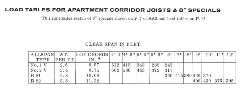

For the short joists, I identify them as B82 joists and they span 15'. The supplement only takes you as far as 12' (image below). It doesn't look very promising eh?
I am wondering if the way to go is to add more supports in between since these are spaced at 24" o.c. Though I don't have the original loading, it would double the capacity of these joists, and I just have to check the beams, columns, footings.
Were you able to download the full catalogue from the link? There may be more span ratings and info in there than in the supplement.
I've had joist suppliers provide new steel joists with a mid-span splice so they can erect it inside an existing building. So that may play well with your last proposal, i.e. adding in additional supports to cut the load on the joists in half.

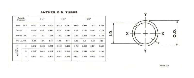

I measured members and performed a structural analysis on both OWSJ types. It turns out that these joists are very different from the ones on the catalogue. As I understand from the catalogue, web members are "rings" that range from 1-1/4" to 2-1/2" diameter. See below. These joists on site are bars ranging from 12.7mm to 14.2mm diameter. Based on my analysis, the existing webs are very weak in compression as the KL/r with these webs is very low.
Could it be that these joists are composite?? If so, how would I go about finding out if they are and its strength?
